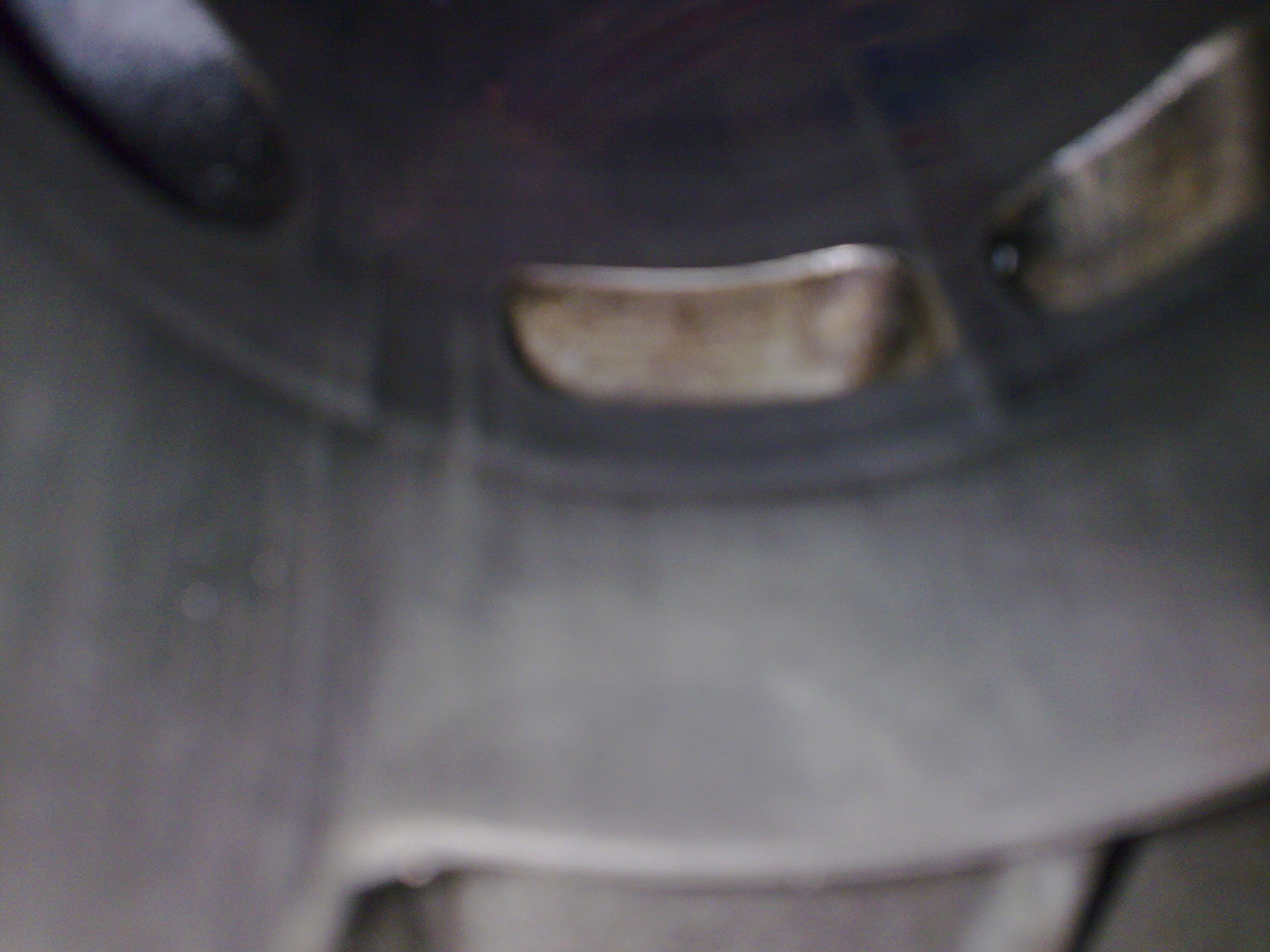

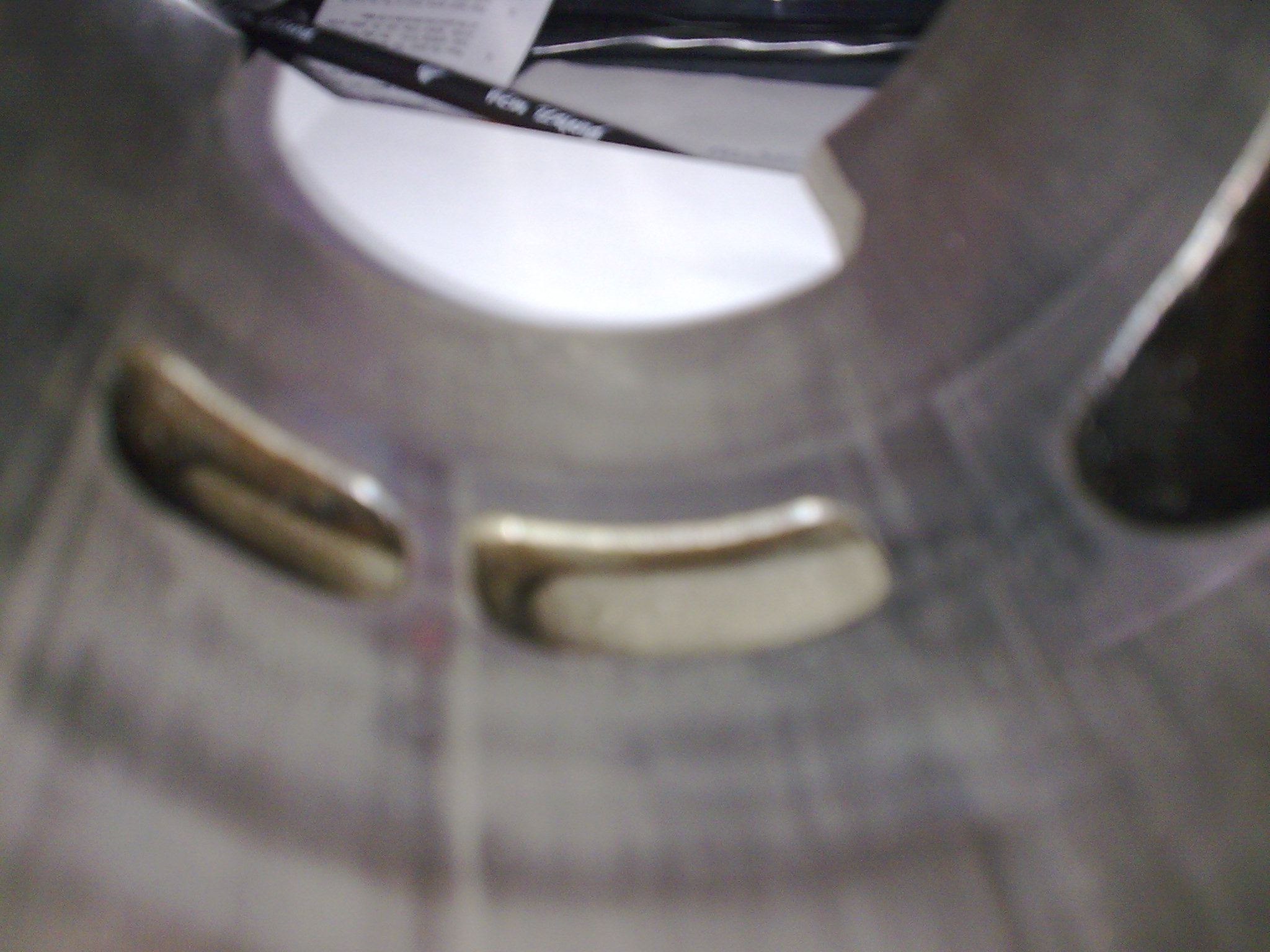

Did you check the condition of the barrel? I managed to warp the barrel on my 01 by getting it wet when really hot, changing pistons had no effect on the noise
the barrel doesnt seem to have marks or anything, what can i check more about it?
Just had a look at my warped barrel & taken some photos which I'll try & work out how to upload
No real scuffs but there is a visible line which can be felt below the transfer ports which goes around below the exhaust as well, most noticeable by the front transfer. Also quite a step at the top of the ring travel
These shots came off my phone & aren't the clearest, have better ones on my new camera but can't find the photos on the computer to upload
