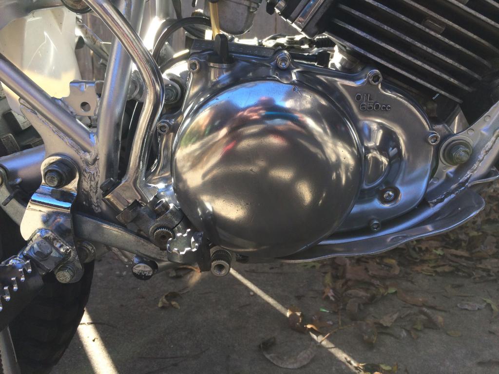

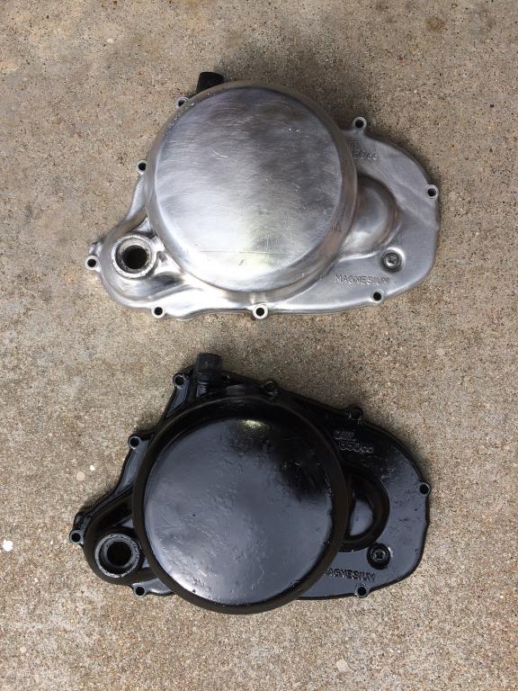

I found these two 1w1 covers, just in case anyone is looking for one. I have one already for my TY175 and it's all shiny!!!
