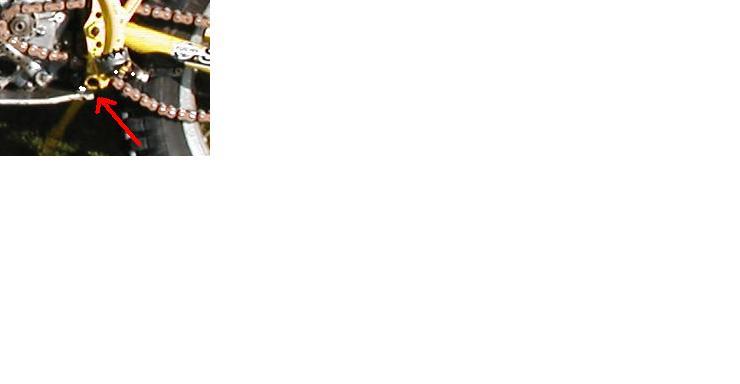

Also, where the frame tubes were cut at the bottom of the frame at the rear of the bashplate for what must have been the engine lifting mod, the tubes were left open. Normal frame will have properly finished tubes. I've hopefully uploaded a picture of what I mean marked with red arrow. I have 2 Yamaha framed Majesties and they are both modified in this way.
