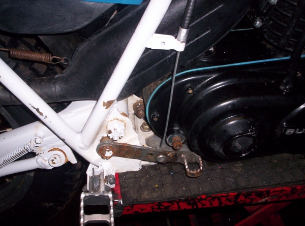

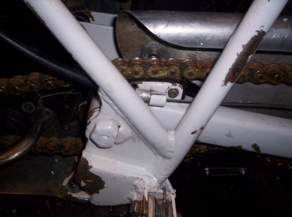

Pictures below from the later bike showing the cable run and mounting points. The brake pedal is one I made to try out to work with lowered footrests. I don't like the original anyway as the pull seems to lack feel and it is the wrong shape for the lowered footrests. I've ridden with this pedal a few times now and it works fine so I'll tidy it up.
You could make a pedal mount easy enough if you have a lathe, or someone to do it for you. Turn a piece of solid bar to the required diameter, drill and thread it at one end, drill a hole in ths swingarm plate in the required position and bolt it to the frame - bolt going in from behind the frame. I don't know what hole is already drilled by your footrest hanger but the 159 doesn't normally have one I don't think. If it is that close to the footrest it may not give the required leverage for effective brake operation
