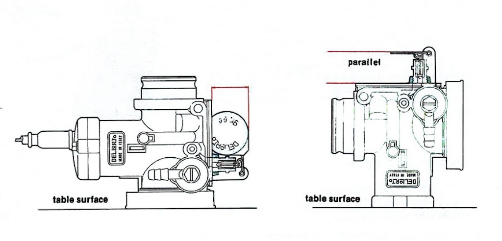

To your questions:
To question Nr. 1:
You should not change the float height in any direction there is only one position it works proper! Check out by turnig the carburator upside down on a table, then look at the arms of the floats that they are perfect parallel to the table.
Look up the instructions book for your carburator, (still not knowing which brand and model you have for the correct distance in mm and 10/mm.
See picture:
