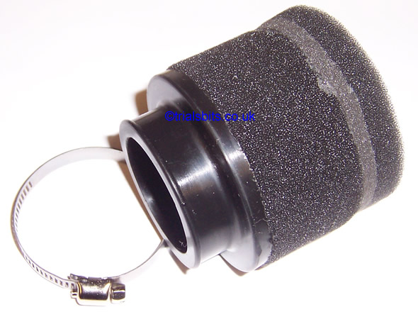

What sort of air filter are you using, ie is it to restrictive ?
Yes, its the white throttle tube and its a conical air filter same as this:
http://www.trialsbits.co.uk/product_info.php?cPath=34_35&products_id=28
Always blow it out after every trial. Tried running it in the garage without air filter and its still lumpy at 1/4 throttle.

Just to confuse the issue,I found your air filter made my B40 run weak, and went for one like :-
lightly oiled with proper air filter oil.
(Also easier to get into a tight space)
