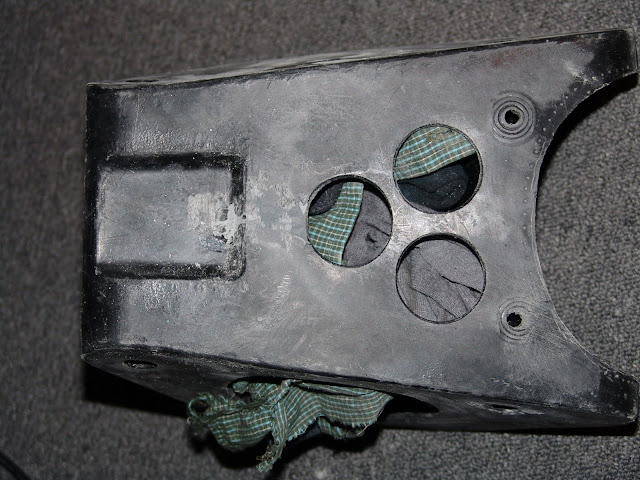

After some use the surface of the tank gets a little bit grey, this comes from cleaning the
tank with rugs an cleaning solvents and look like this, the greyish color comes from micro scratches
on the above located surface, the "lower" situated surface is still ok and so the blue is still visible.
As I mentioned already in my first post a photo of the tank would be nice to look up what is the best procedure to solve this problem, we don't have any so we have to guess.
Nevertheless the grained surface is very smooth, the "modulation" might be 200 - 400My, (0,2 - 0,4mm) as already stated with the fine sanding you can get the surface clean and when beginning with fine sandpaper the hopefully clean (*) lower surface will remain. If the tank more scratched or white then use a eccentric sander, beginning with 150 grain then 240 grain, you simply align the surface. then follow as mentioned befor.
Best way is to make some small test where you later not see your try out, like the surface under the seat.
If I have enough spatretime, whichever is rarely, I can show it.
I still have the old gastank of my bike laying around in the garage, (production year of the gastank is 1978! but was fitted to a 199b), the bottom filled with gas gum, plastic penetrated with premix, paint showing bubbles, ...), I can make a quick show and tell if someone is interested.
