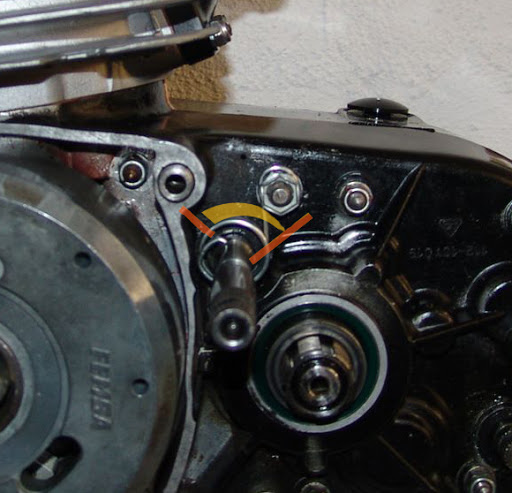

hello nice engin thanks for the addvice. ive sprayed my cylinder head black would you think it would be ok if i lelft the barrol siver? can you tell me how to put the kick start return spring on?
Painting the cylinder head black, engine body is black too and leave cylinder blasted, Mmm ... well you can give it a try.
The kickstart spring mounting you find here: # 5 and # 6

hi again think ill paint it black might look daft. geting back to the return spring when you put it on do you have to have the shaft winded back so then it will return? cant get me head round it thanks for the sketch.
Black is nice too! Yes you have to trm the kicker shaft about 1/4 backwards otherwise you won't have enough space for mounting the spring.
