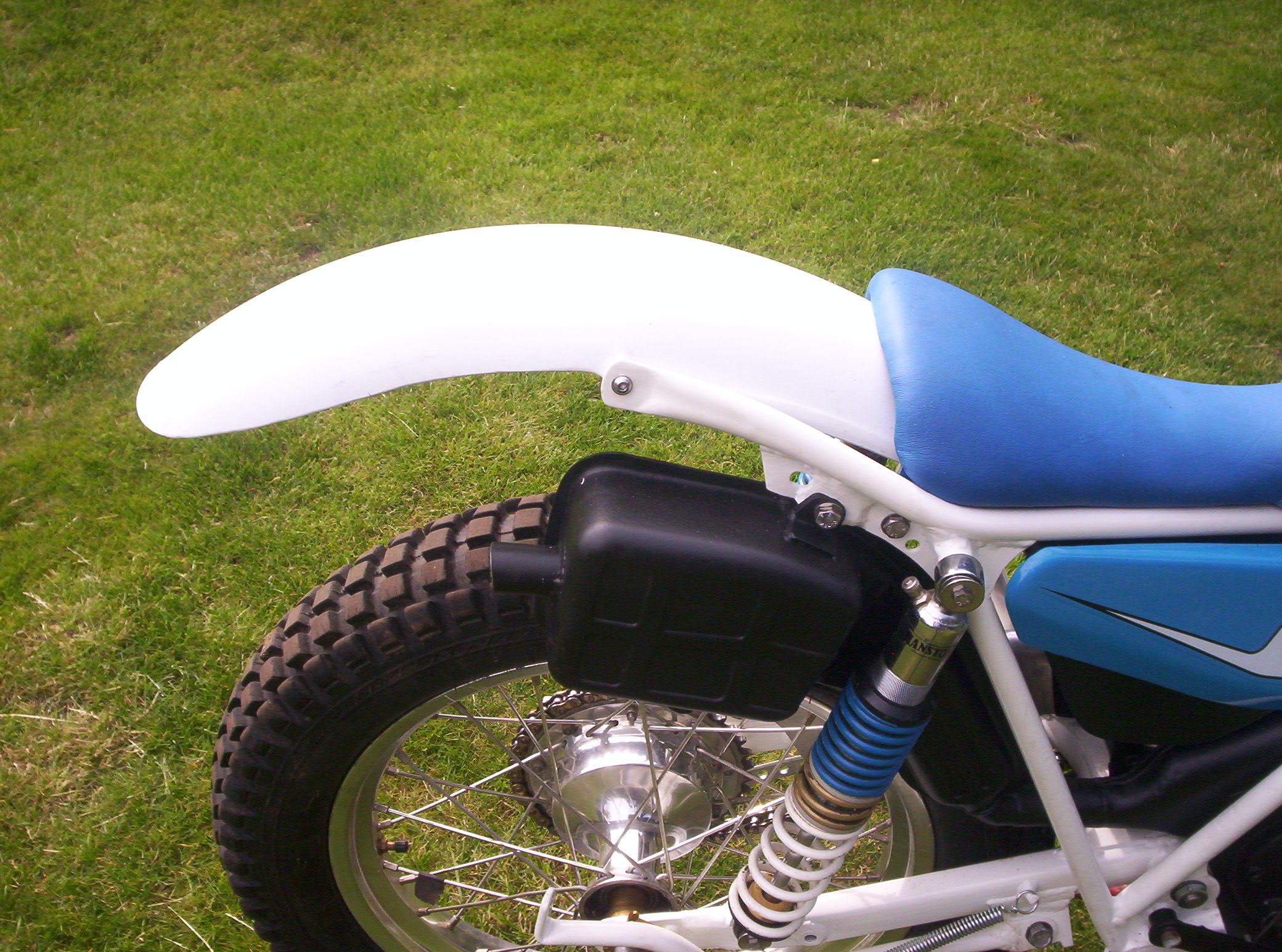

What do you recommend as a replacement for the rear box on a 199A?

Nothing to be honest, what's wrong with it? They, or the earlier 'banana' type, are a good replacement for the triangular one on the earlier models.
As long as it isn't clogged up it should work fine. The section that runs up to the shock is perforated tube and the packing can get clogged or just disintegrate and get blown out. It can be cut open and repacked but it's a messy job. From the shock to the outlet (ie; the box section) it is full of baffle plates, presumably for the job of spark arrestor, so there is nothing to repair in there as long as they haven't come loose, I can't see how that chamber can get blocked up. As a mod, the plates can be cut out and the perforated tube extended to the outlet, effectively giving it the same internal arrangement as the banana type which is tube all the way through. The outlet just needs to be changed from 2 to one larger hole, as below
