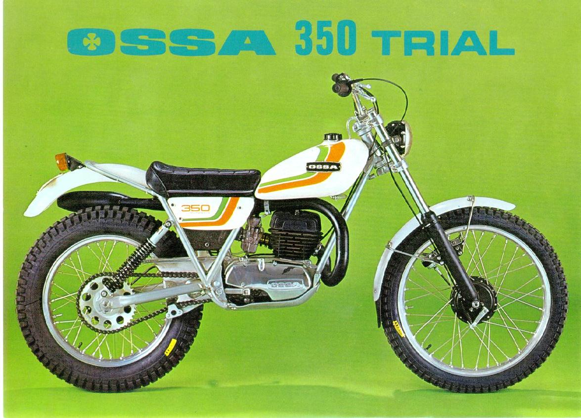

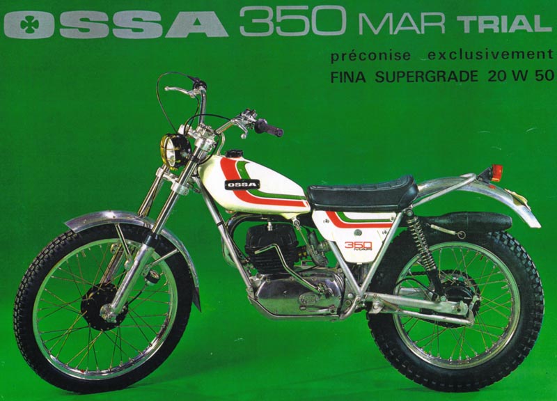

October 15, 201115 yr It's hard to tell from the picture but it looks like a MK2 (74/75) that has had the shock position altered to copy the MK3. The bottom shock mount is typically where the MK2 would be but the top mount for a MK2 is at the top of the frame tube where it meets the frame loop, right under the rear of the seat. The MK3 top mount is roughly where yours is. The MK3 swingarm shock mount is over the rear wheel spindle - so you have a cross between the two. The MK3 has longer forks than the MK2 - yours are MK2. So, either someone has modded a MK2 to almost MK3 positioning or it is a MK3 frame - identical to MK2 apart from shock mount position. Shocks on both MK2 and 3 are the same length - 13.5" or 250mm, give or take a little. This is a MK2 This is a MK3
