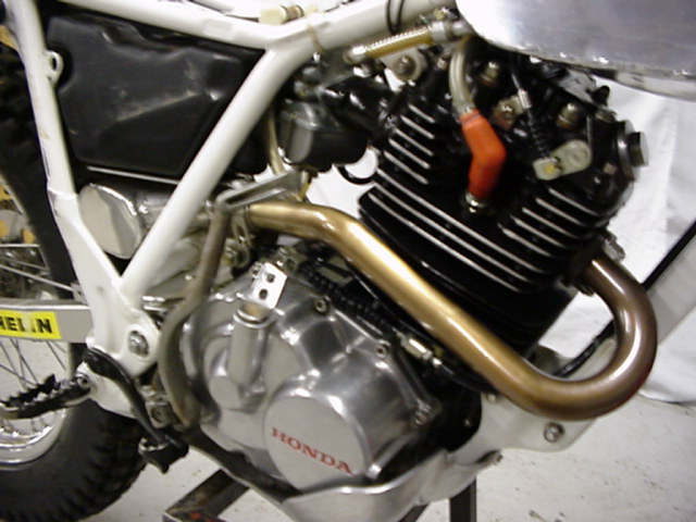

I have a TLR 250 with an external oil feed,see picture. is it still possible to fit a manual de-compresor ?
Edited by superhondaman
Looking at the picture I cant identify whether there is a decompressor lever still on the rocker cover.
If there is what I would be tempted to try is re-routing the oil pipe so that it comes from the back of the bike rather than the front to the bike.
It also looks as if the oil pipe masks the normal bolt hole for the cable bracket.
One drawback of this is that the metal oil pipe will likely run close to the plug lead - sheath it in rubber at this point to reduce risk of spark shorting out.
You could make up a cable bracket from one of the cylinder head studs or from one of the rocker cover bolts - it is going to be tight but would work. the cable routing isnt going to be perfect but you dont need a strong pull to make the valve lifter work and an extra spring (along with the normal Honda return spring) between the outer cable and valve lifter lever will ensure that the valve lifter closes properly.

Is that an after market item or honda one? & is it activated from a lever on the bars.
That is a standard Honda decompressor - but whether the proud owner has set it up to work from a lever on the bars like I have I could not say. Normally the cable goes to a fitment to the rear of the kickstart.
Yup,
Pretty standard set-up as far as I'm concerned, watch cable routing under the tank though, you can get a little snagging if you are not careful. Lever and cable can be obtained from that nice Mr Miller in Hampshire, don't know about the lifter it'self

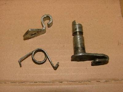

Ok i have got hold of the lifter,spring & bracket (from ellastone off road) so if i undo the screw holding the plug in (see pic) will the lifter fit straight in?
99% sure it will from memory - need to check alignment when you push it in, otherwise it wont go in!
