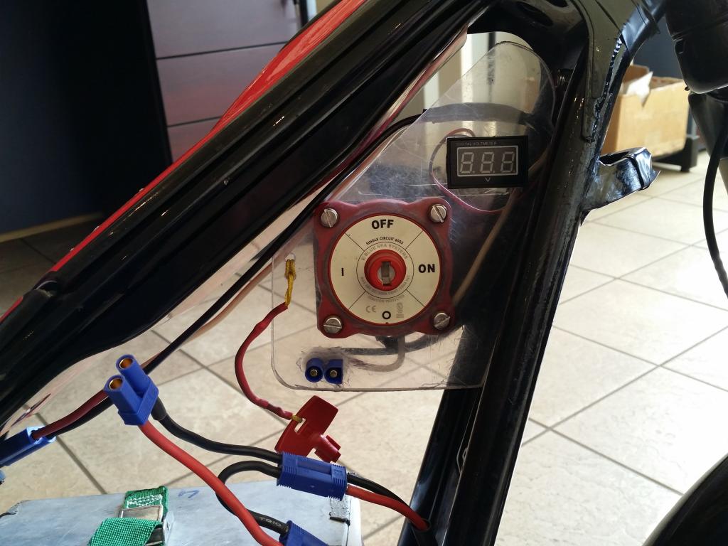

Installed a battery cutoff switch and a small voltage display to keep an eye on the lipos.

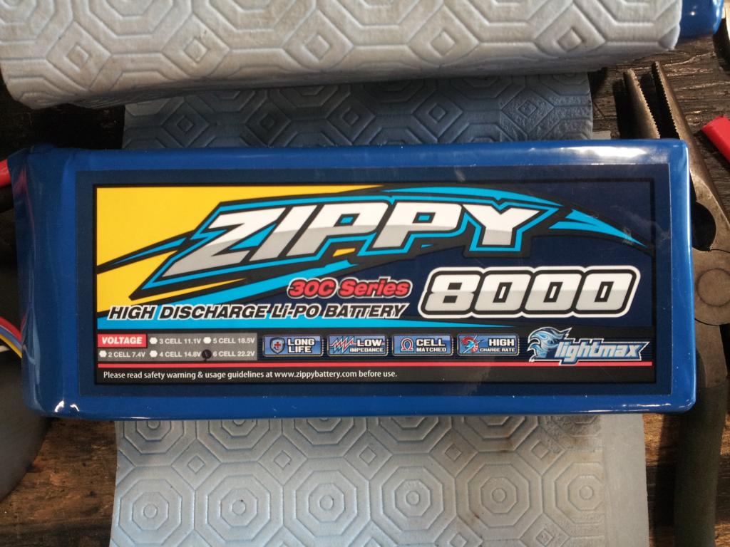

Hey sveson, I bought 6 of these. put 3 plus 3 together. 8000 Ah each
Run-time is amazing. We can do a whole trial competition together 40 sections.

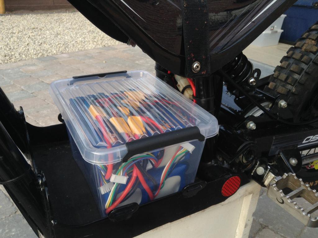

Here's a picture of my lipo battery case.
How did you guys fit the batteries?
I have 16 for my 4 year old son, so no need for very tight strapping just yet.
