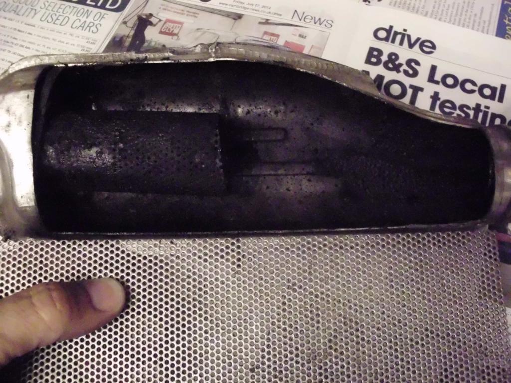

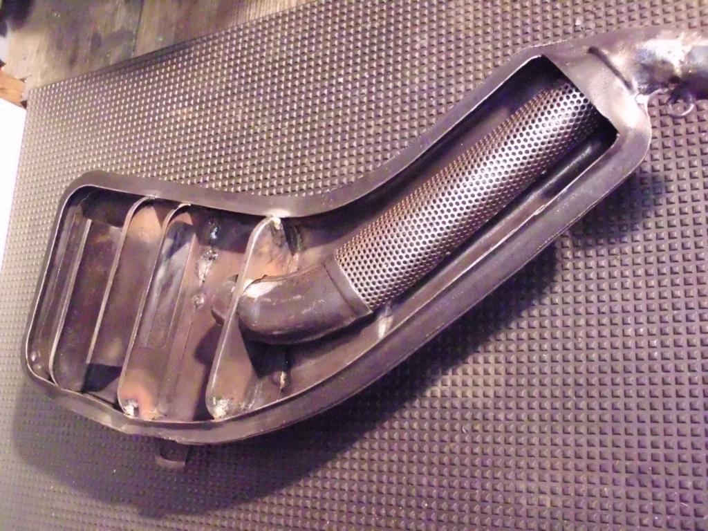

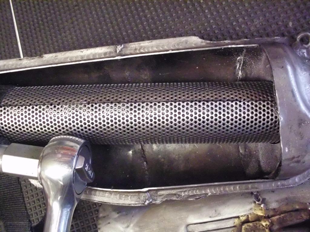

Hi Scot, it's worth doing and as you can weld you'll have no problem.I did it on my nephews Gas Gas and it transformed it.I've done it on my 191 but as it's not finished i can't comment on the improvement yet.Hopefully i've attached pitures so you can see whats inside ( please note on middle box a previous owner cut it across it's length! this will be tidied up later) I would suggest that you remove and replace the perforated tubes as they are very hard to clean properly and you can buy perforated sheet cheaply and make your own.post-16352-0-27696700-1359317591_thumb.jpgpost-16352-0-67097900-1359317623_thumb.jpgpost-16352-0-18146100-1359317649_thumb.jpgpost-16352-0-29695900-1359317672_thumb.jpg
Thanks Colin for the great pics.I had to disassemble the bike today so I could cut the swingarm bolt out.When I removed the end silencer I noticed something loose inside rattling around.I wasn,t sure if I was going to cut it apart,but now I am and your pictures are a big help.I would assume,from what I,ve read,that it would be the perforated tube thats come loose,but it sounds like it,s in the end like maybe a baffle plate.

Hi Scot, I'm lucky enough to have a long established hardware shop nearby that has a metal warehouse.I think it was only about £6 or £7 pounds for the piece in the middle box and not much more for a bit big enough for a couple of attempts at the one in the rear box, they were both under £10 each.I would suggest you use a thin 1mm cutting disc and try not to cut too deeply around the baffles, i had to fill the places where i'd nicked them with a spot of weld.As you're not exactly local have a look on-line,someone must sell it over there.
ebay sells perforated steel sheet.
If it helps it was on receipt as mild steel perforated sheet 2x3x1mm and it was £7.72 for a piece 15cmx25cm.
