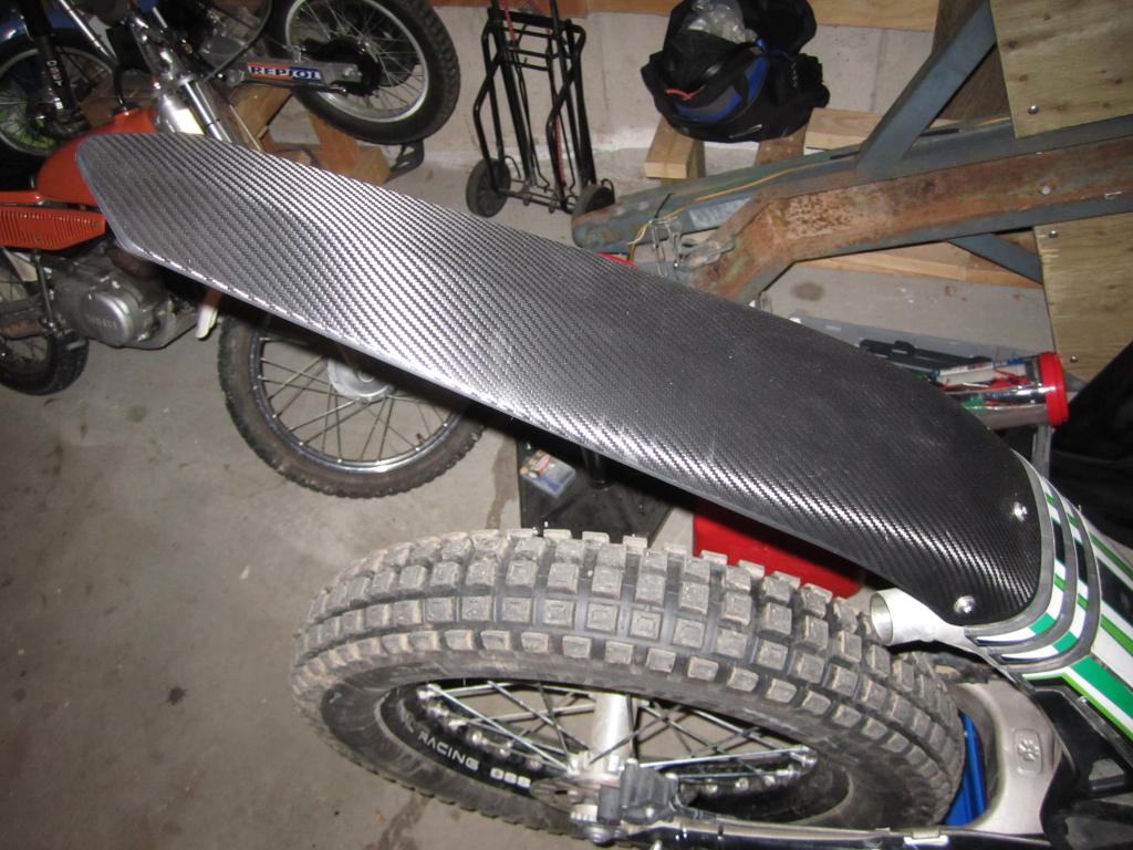

In case you are interested the new flexi fender is a straight bolt-on to the old style seat base. I just installed one
Edited by canada280i
Have you a pic please.
pics attached
