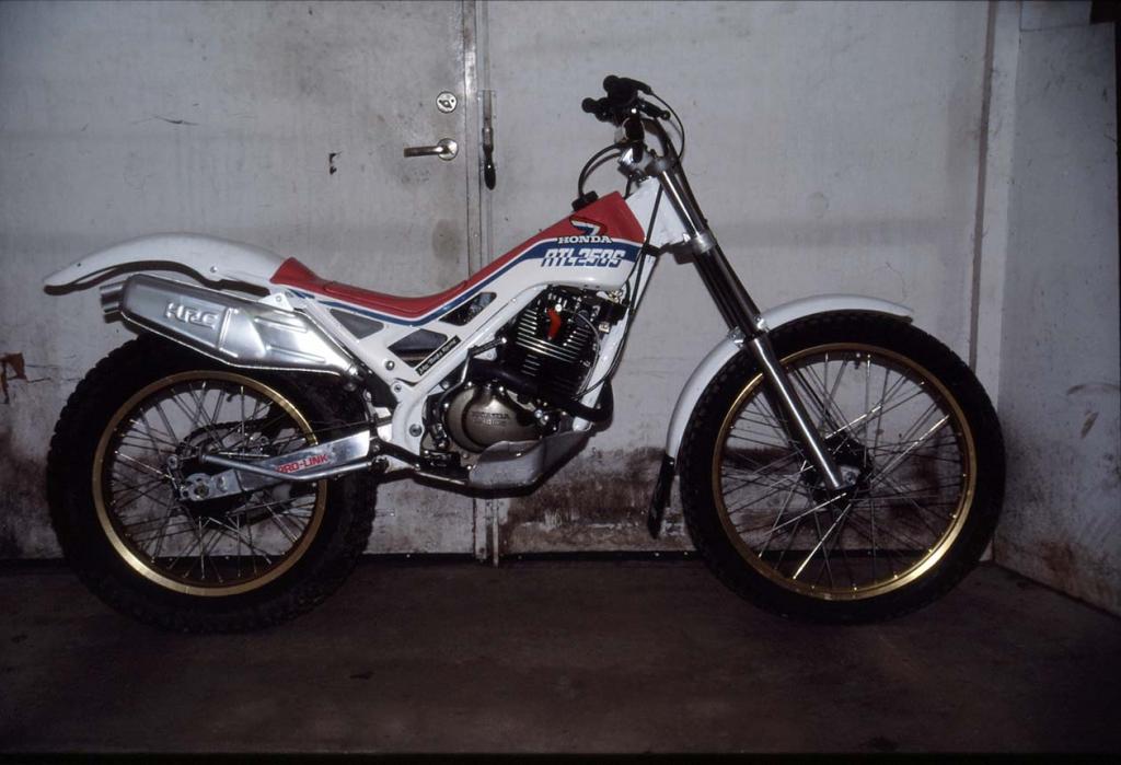

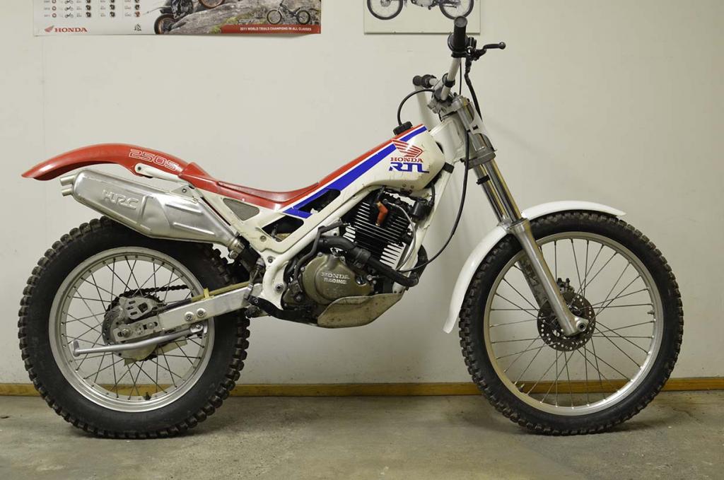

This is how it looks today.
A photo on the same bike from 1988

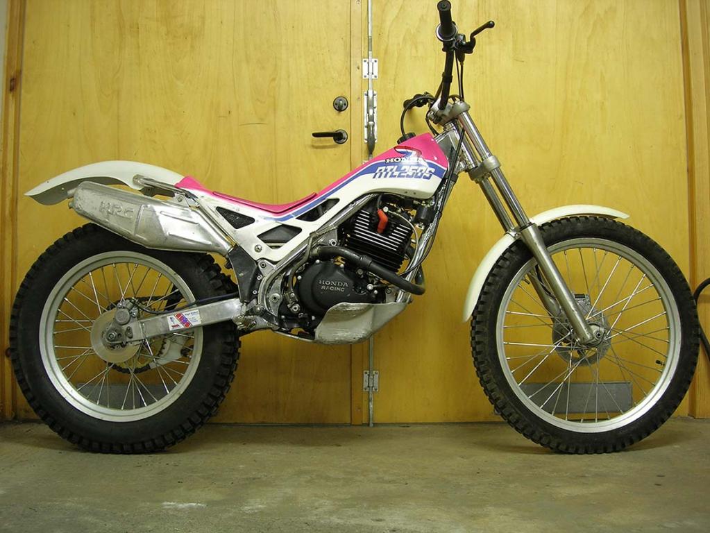

When I ordered the wheels form Japan I also got me one of these just for fun :D
I was in Birketts when he did the modification. Much frustration as it had to all line up perfectly, probably wished he never took on the job.
I think the rear swing arm may be a GasGas as it does not look like an original but could be my memory.

Might be my eyes but on the second photo it looks as though the rear brake is rod operated.
It is actually cable operated but there is no conduit on the cable. It looks like this:

I can imagine the frustration of Birketts because the alignment is one of the reasons I'm converting it back to drum brakes. Every time I take the wheels of I have to get everything lined up perfectly otherwise the brakes will squeak or not work properly.
The rear swing arm is original as far as I can tell. There is no marks from any cutting and re-welding apart from just in front of the brake caliper. Maybe that bit has been changed to accommodate the caliper.
