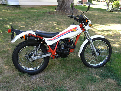

New to trials. Have a Honda TRL200 Reflex that I restored two years ago. Hoping this year to actually get in some practice riding. I'm middle aged... about 155 lbs.

That thing is CLEAN!!!
I would say 5-7 psi in the front and 4-5 in the rear.
I can't tell if you have a rim lock in the rear, but if not, you should install one if you'll be riding low tire pressure.

Hey what is that Reflex like to ride? That's a nice little bike there

Clean? Well, it should be since it has yet to see dirt : )
As to riding it, again, I cannot give you much more until I actually do ride it more than around my back yard. To be sure, it is a very strong bike compared to my CR80 and I'm a bit nervous about riding it. The engine has been rebuilt and the compression is very high.
