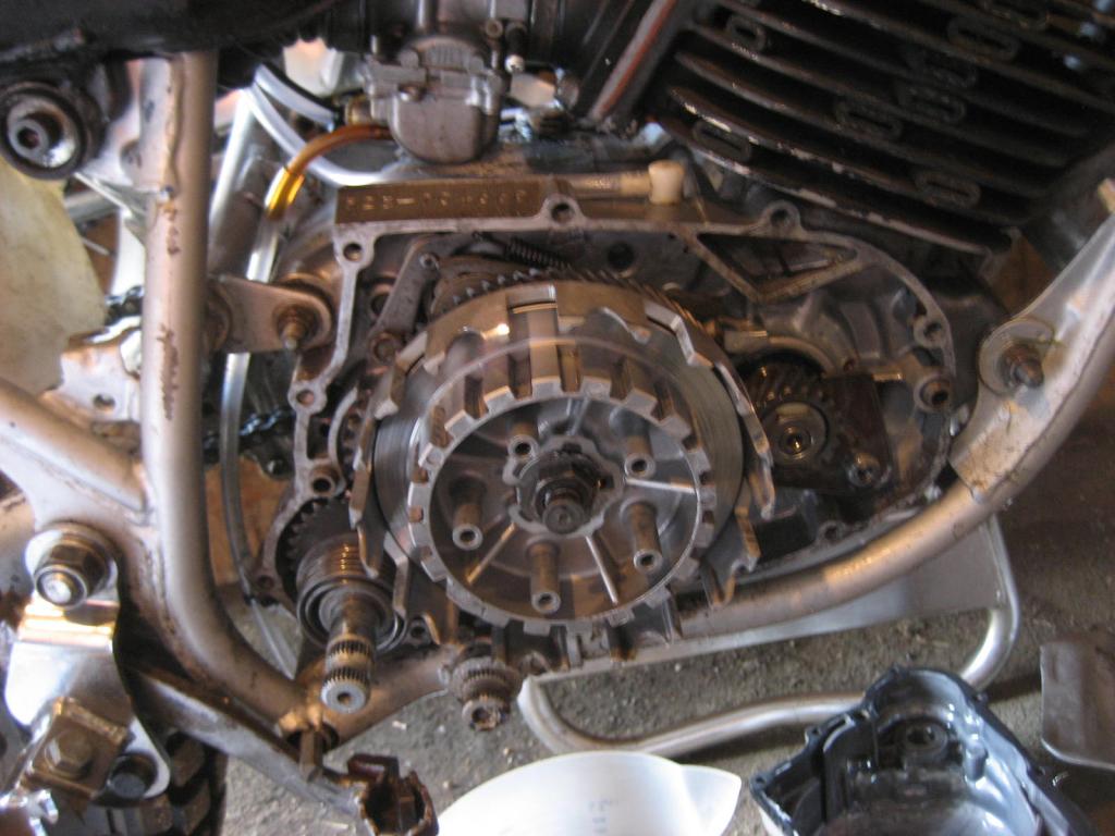

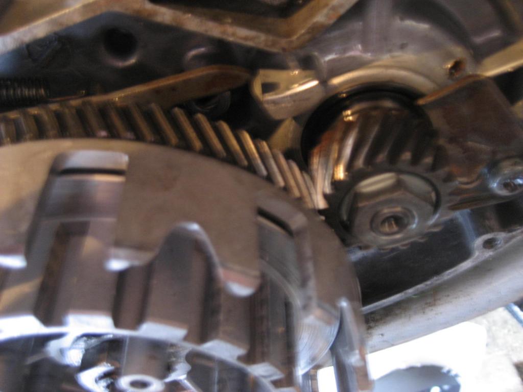

Opened up the TY this morning; no loose stuff causing the rattle, but the outer clutch basket has some play, both in and out play - which I think is normal - and there is some rotational movement between the outer clutch basket and the cog that it is attached to - and i'm not sure how normal that is (nothing in Haynes or after a google)
is this normal?
cheers
The rotational play to the big gear is fine unless it has worn the cush rubbers so much the rivets hit metal to metal. 2-3mm play at the OD is normal
It is common to hear a rattle with the clutch pulled in in neutral - on many bikes. It is the sound of the steel plates rattling on the splines of the hub. If you let the clutch out the steel plates are held firmly so don't rattle. If you put it in gear the drag of the friction plates against the steel plates causes the steel plates to be held against the splines of the hub, so don't rattle. Clutch released, in neutral = rattle = no worries mate
