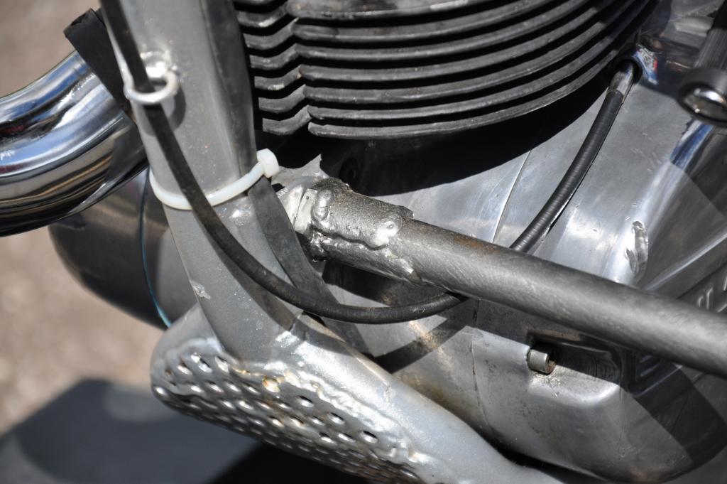

I made the brackets to fit my chair to my Bultaco from 3 mm and 5 mm plate. You should try to pick up on the swing arm bolt and the foot peg mount with your first bracket. Then the front engine mount/bolt with the front lower mount. Front upper mount can pick up on the headstock web under the tank ( make sure it's low enough to clear the tank)
My 14 year old son did most of the welding on our chair as a learning project.(yes some weld's were ground out and done a second time. But we have had NO breakages)
So go on give it a go!post-2720-0-36311800-1376430652_thumb.jpgpost-2720-0-95249300-1376430769_thumb.jpgpost-2720-0-21709300-1376430876_thumb.jpg

The examples pictured do reflect what I was trying to get across, notice nothing is welded to frame, all bolt on bracketry. no clamp on brackets used, however on different bikes that may still be an option. Don't look too bad either. Good welder can make MIG look better even, takes practice though!
