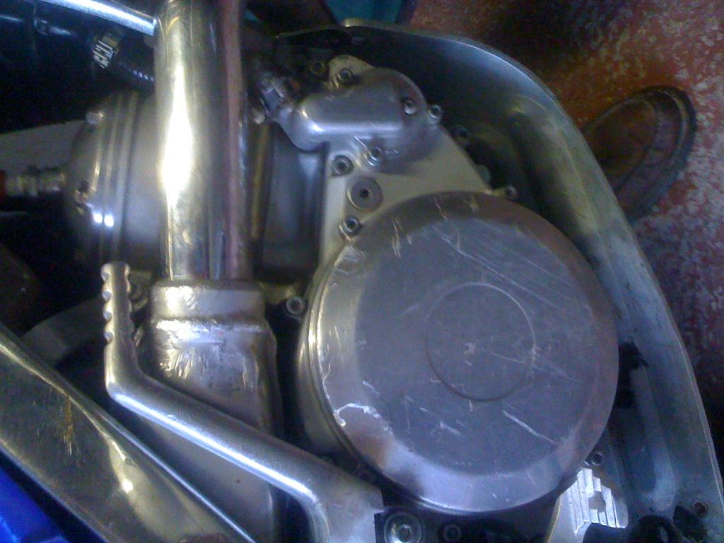

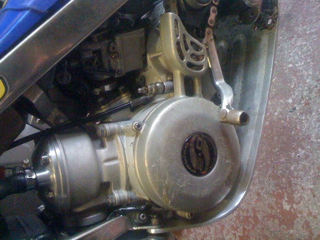

northern1 Posted August 14, 2013 Share Posted August 14, 2013 Hi, Ihope someone can help. Just bought a Sherco 200 2005 model but can't work out how to check and change the engine/gearbox oil. Can someone point me in the right direction. Thanks, PJ. Quote Link to comment Share on other sites More sharing options...
charlie chitlins Posted August 14, 2013 Share Posted August 14, 2013 No provision to check it...just change it. Lowest crankcase bolt on the left side. 450cc of whatever oil you prefer. Quote Link to comment Share on other sites More sharing options...
hugo Posted August 14, 2013 Share Posted August 14, 2013 Look at this document from the Sherco USA website, there's a section for "transmission oil change" with pictures and all... http://www.shercousa...ation_guide.pdf Quote Link to comment Share on other sites More sharing options...
northern1 Posted August 19, 2013 Author Share Posted August 19, 2013 Thanks very much for your help guys, job done. PJ. Quote Link to comment Share on other sites More sharing options...
t-shock 250 Posted August 19, 2013 Share Posted August 19, 2013 Are you sure its a 2005? the blue plastics & yellow sherco frame sticker would suggest an older model? Quote Link to comment Share on other sites More sharing options...
northern1 Posted August 20, 2013 Author Share Posted August 20, 2013 To be honest, no I'm not sure, how would I find out for sure what year it is? PJ. Quote Link to comment Share on other sites More sharing options...
t-shock 250 Posted August 20, 2013 Share Posted August 20, 2013 Post a picture on here or phone MRS with your frame no. Quote Link to comment Share on other sites More sharing options...
