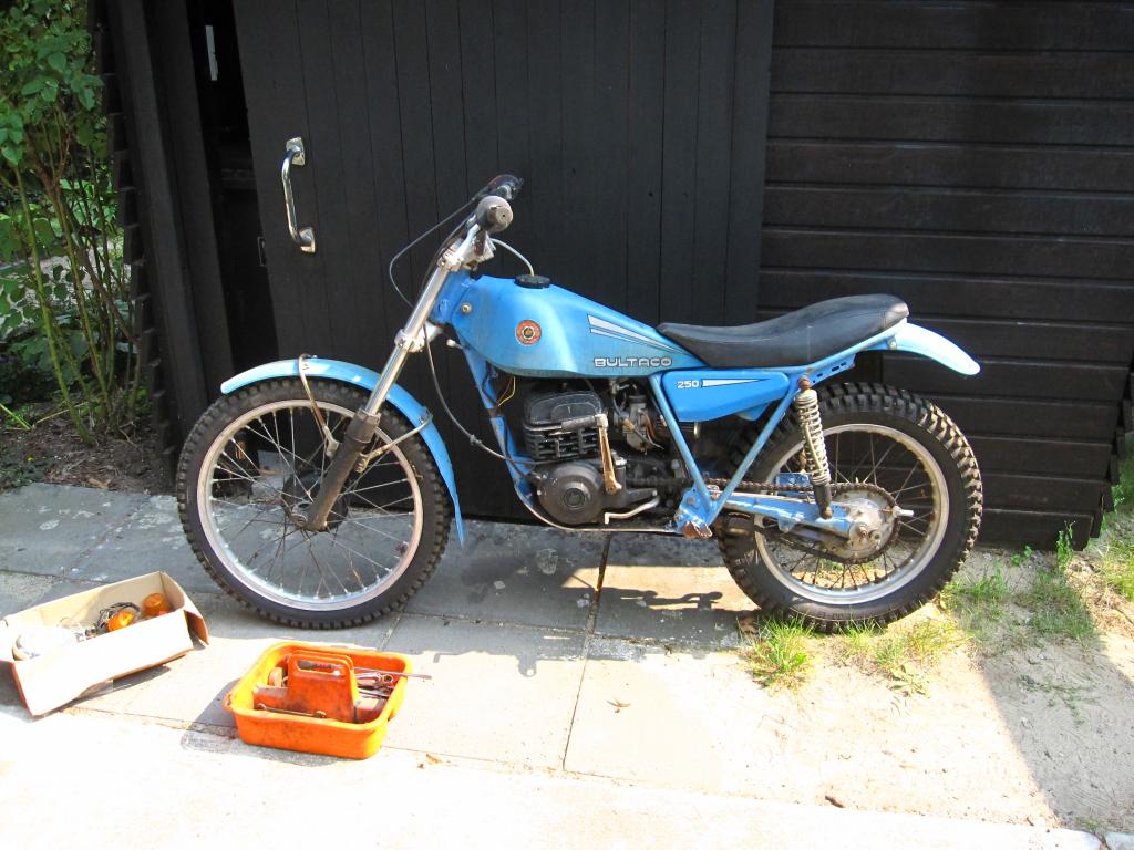

i just got a 198 sherpa from a friend, which i'm currently trying to "restore" -- well, - at least to get it running good and fast again.

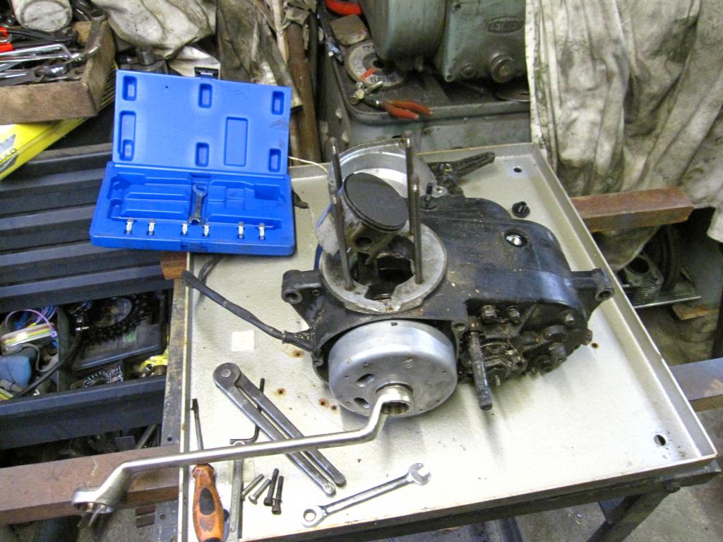

I attached some pictures of the tools i had to build so far for disassembly. Currently i'm building the crankshaft removal tool, and think about fitting a light generator with a small rotor which has a weight of 700 gramms, to get rid of the 1700g femsa rotor.

hi to split the case first take the clutch basket off and weight then gear selector. also the magneto and igintion plate undo the 12 nuts on the L/H side then put the engin in the oven for 15 minets at 300f if a oven is not possibal use a blow torch.and concentrate the heat all around the middal of the crank cases shouldnt take long before you can split it. if the pin is stiff heat the piston up a littel then the pin should come out really easy. as for the piston if its damaged your probley better just buying a new 1 and get the barrel rebored.

Splitting the cases doesn't look like a big problem to me, either. I got the piston removed, but while i've disassembled and assembled quite a lot engines so far, i never came across such a sticky piston pin. Even heat didn't help very much, - propably there was too much carbon and other dirt in the piston pin bore which's hard to remove prior to piston pin removal.
