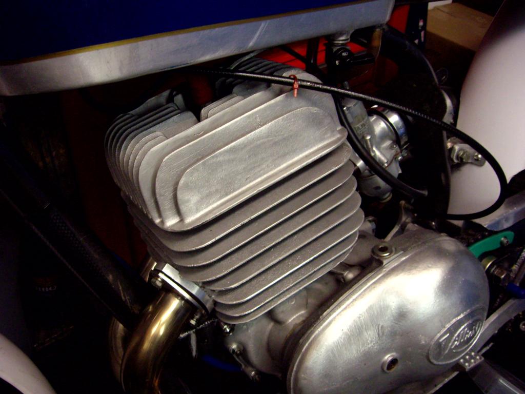

yes, head not matching barrel
Parkinson barrel (cast-in manifold) and DMW head (close-pitch fins)?
The head is a Parkinson
I'm not sure about the barrel, it's not a Greeves or Marcelle so could well be a Parkinson also.
Why do you think the head and barrel are mis-matched??
Edited by sparks2
I think the Vale-Onslow conversion had round finning.
Mick's and farmer's both have 7 fins. (so it's probably a Parkinson)
