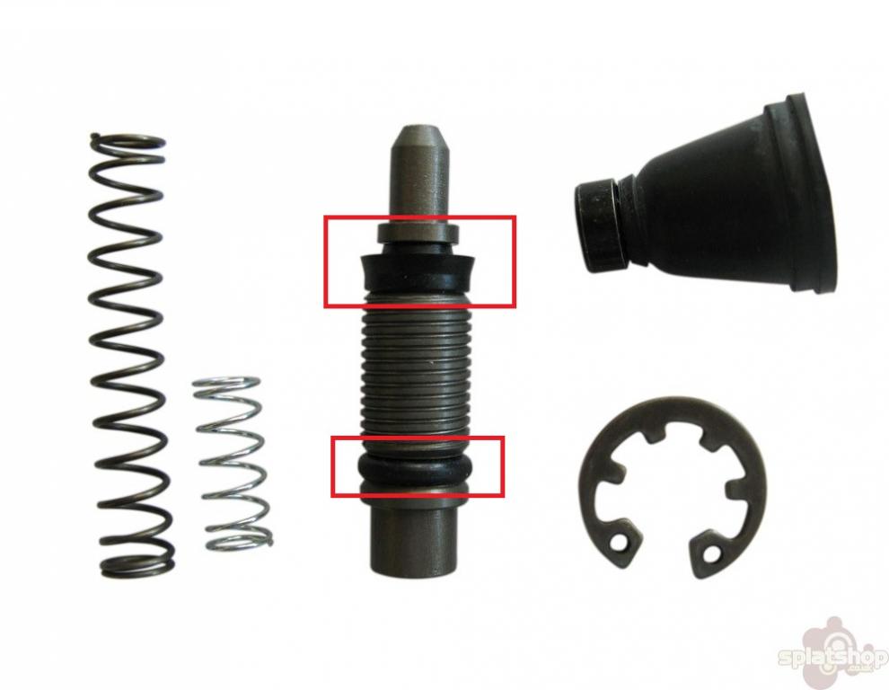

I seem to have oil coming from the boot on clutch lever master cylinder? do I need a new boot or a whole cylinder repair kit?
Repair kit, I had one go and it was the o ring on the plunger, you could try just the o ring but the kit is cheap enough for peace of mind
Plunger o-rings are most likely worn. The boot is only there to stop dirt for getting to the plunger not seal oil in...
