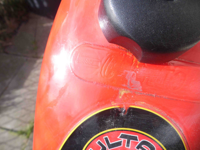

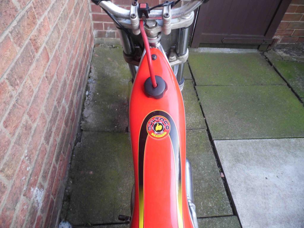

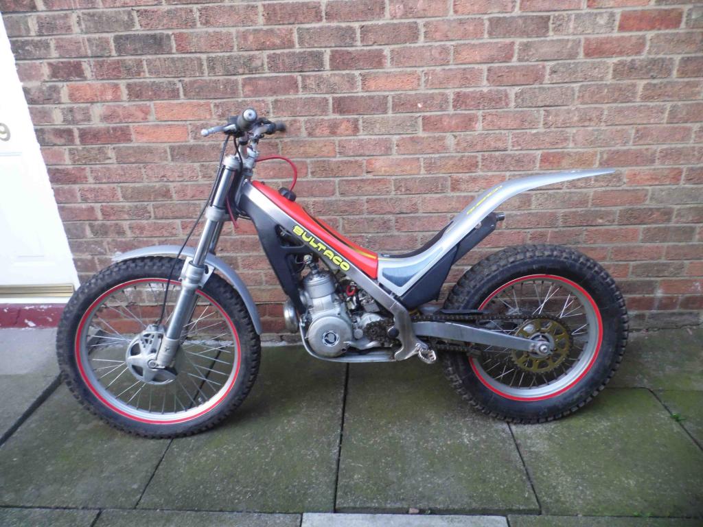

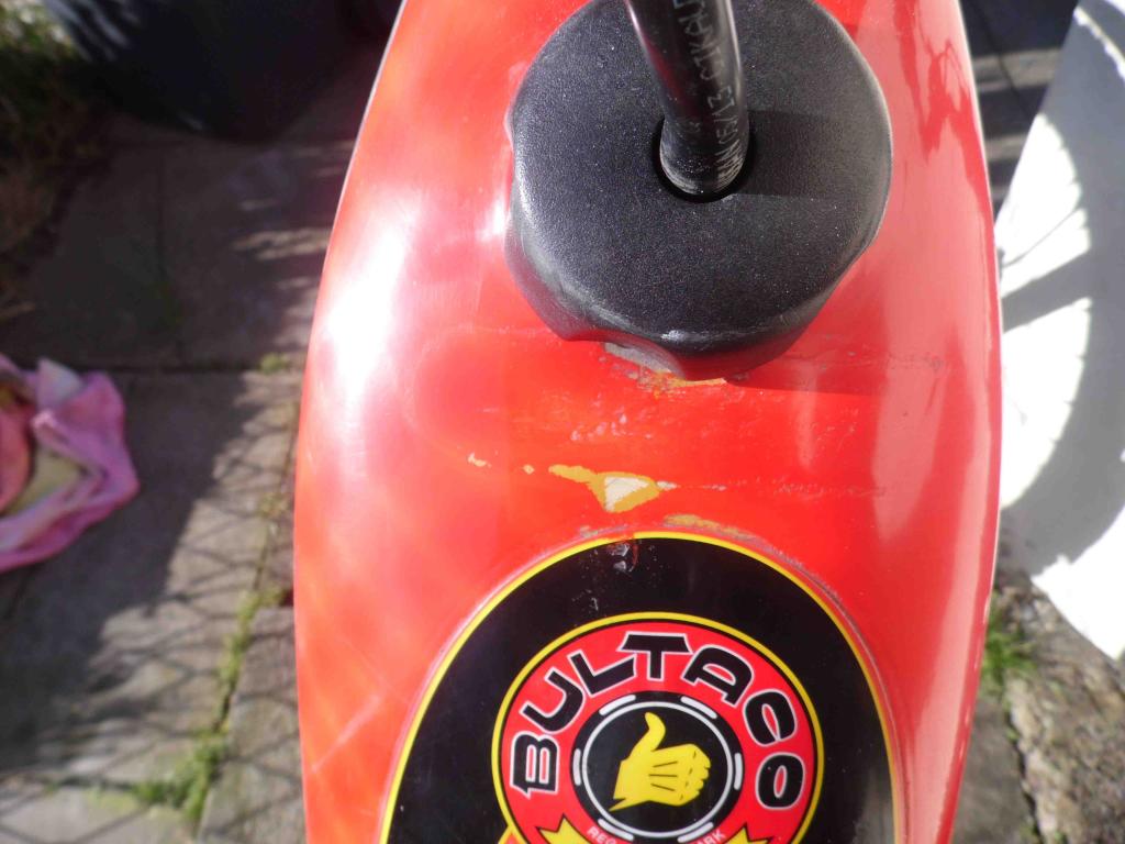

i had to kind of guess the colour when i went to buy the paint, i took a photo with me but they aren't that accurate, the colour for a perfect mach is ford sunburst red, i will have to put a clear coat on top but i was really happy with the result, this was coused by simply putting a sticker over a mark that was done by fuel leeking on to the tank, i don't know how long it took to do the damage as the sticker was on when i bought it, it must have sum sort of reaction to the tank paint.
post-19186-0-07909900-1393009298_thumb.jpgpost-19186-0-59428400-1393009406_thumb.jpgpost-19186-0-86856100-1393009415_thumb.jpgpost-19186-0-00024800-1393009427_thumb.jpg
That looks quite nice actually for a spot repair. I would go to a reputable auto paint shop and have them clear coat it with a good 2k fuel resistant clear coat as used in that arena. Should shine like a new penny!
