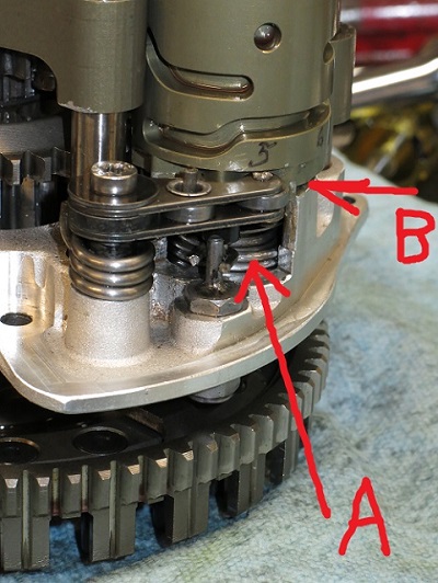

Hey Mac, I replied to your post on OSSA forum:
As for the shifter not moving. One thought is the shift return spring has slipped up and forced the shifter assembly up. Then when you tighten the tranny in place, it has an extra 2-3mm on the shift drum.
Any chance you can take a picture of the shift shaft assembly on the tranny and post it?
I have posted what mine looks like with a point to the spring. "A" show the shift drum nicely sitting close to the tranny plate. "B" points to the shift return spring which can pop off the shift shaft assembly and force the drum up 2-3mm.

Hi mac73,
all the bikes have only one washer placed in between the spring (point "A" of the picture from trialtrial) and the selector drum.
I had to replace the selector drum+selector shaft last december and I had the same problem than you!
I was sure that one washer was between the spring and de drum but I didn't remember the other washer on top of the drum. But when I received the parts from my dealer, a washer was already on top of the drum. So I decided to assemble the shifter shaft with two washers, one in each side of the drum...
After wasting my time for a complete weekend trying to put back the gearbox (but having the same problem than you) I decided to ask my dealer...: the factory ships the shifter shaft + drum + SPARE washer on TOP of the drum, but it is only because it is easyer to ship the washer on top than in the lower part of the shifter shaft!
