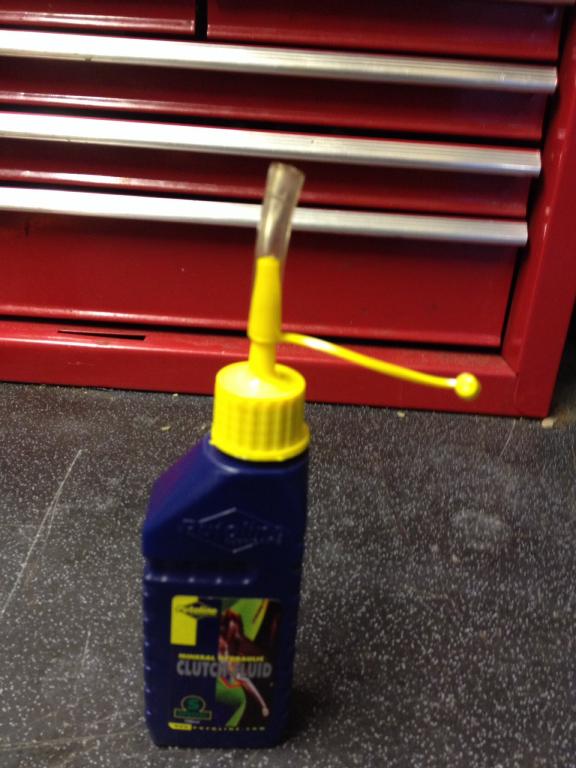

Made a bleed device for the clutch, just pop it
On the nipple open it and squeeze the bottle with
The master cylinder lid off and hey presto
