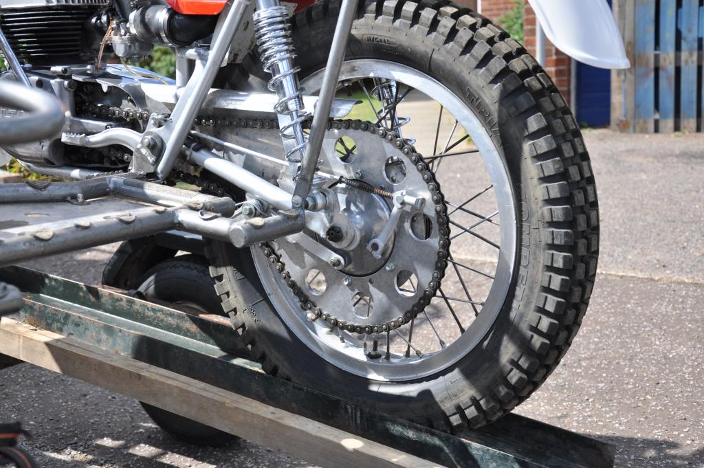

Talon engineering here in the UK are great. made me a 60 tooth Yes SIXTY Tooth 520 sprocket for my Sherpa Model 49 as I pull a sidecar with it. http://www.talon-eng.co.uk/product_category/sprockets/
