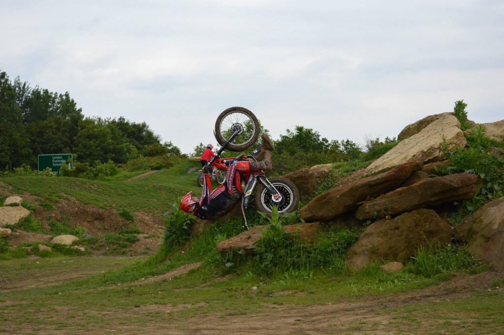

Try this technique.
Made me use my back brake!
Looks like you learnt the hard way :)
Try this technique.
How exactly did you manage to get into that position?

Try this technique.
What a awesome pic :). Would you mind if I shared (facebook) the pic with some trials buddies?
