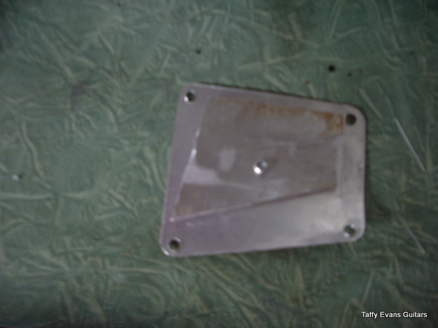

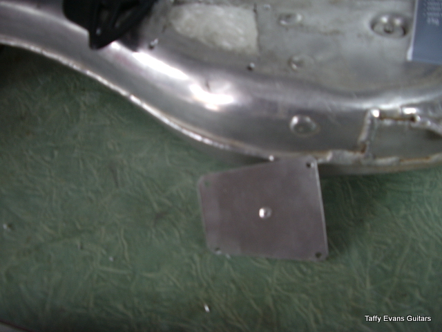

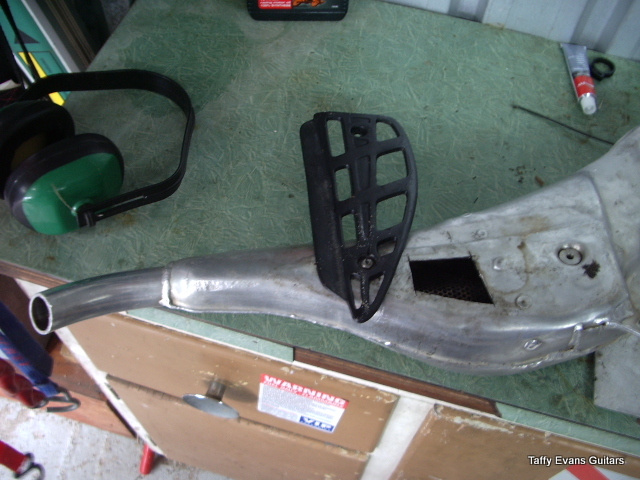

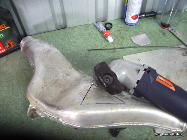

Hi, I repacked my muffler by cutting a window in the front and riveting an aluminium plate with metal putty back over the hole. You can't see it as it's under the plastic heat shield. The muffler was full of soggy matting that you could ring out. After 5 years of neglect by the previous owner it was well worth doing.

Hi Yam, lets hope this all come out, first time posting pic's on this forum.
As I was not sure what to expect I cut the first hole too small so cut another to get better reach, even then it was still a pain to get all the soaked material out. There's a pic of the different tools I used to get the crap out.
The pieces I cut out were reused to fill the holes but with an oversize piece of alloy sheet riveted to them to leave a flange to create a better/ stronger seal. Using the metal putty and rivets I hoped to be able to gain access again in the future, if I re-welded things would be harder.
It made a huge difference to the power of the bike so definitely will do it regularly. Hope this helps, good luck.
Taff.
