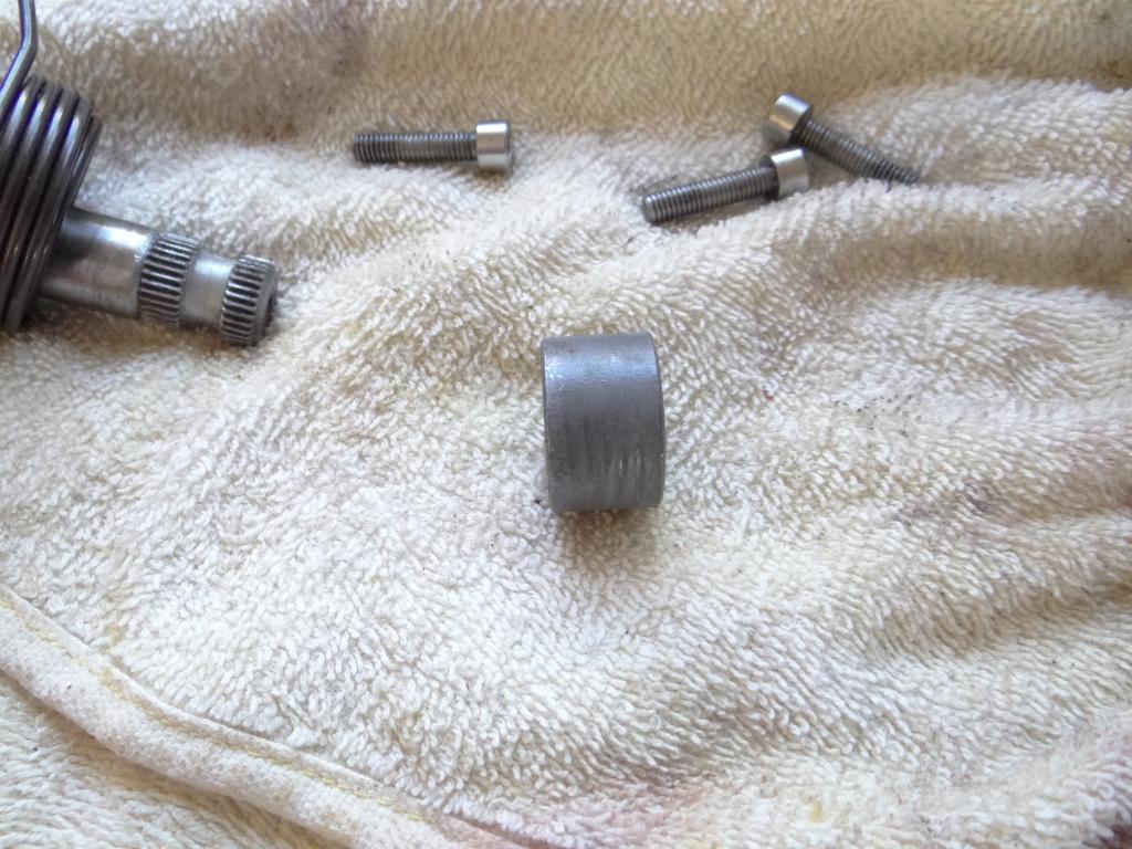

I am about to buy all new pieces from TY Trials...including the shaft and the associated gears. Do I need to do this or am I missing something?? The one odd thing about my kickstart assembly is the the spring guide is a machined piece of metal and it is retained on the shaft with a circlip. I don't see this in part books. What I see is a white plastic piece that apparently is not retained at all.

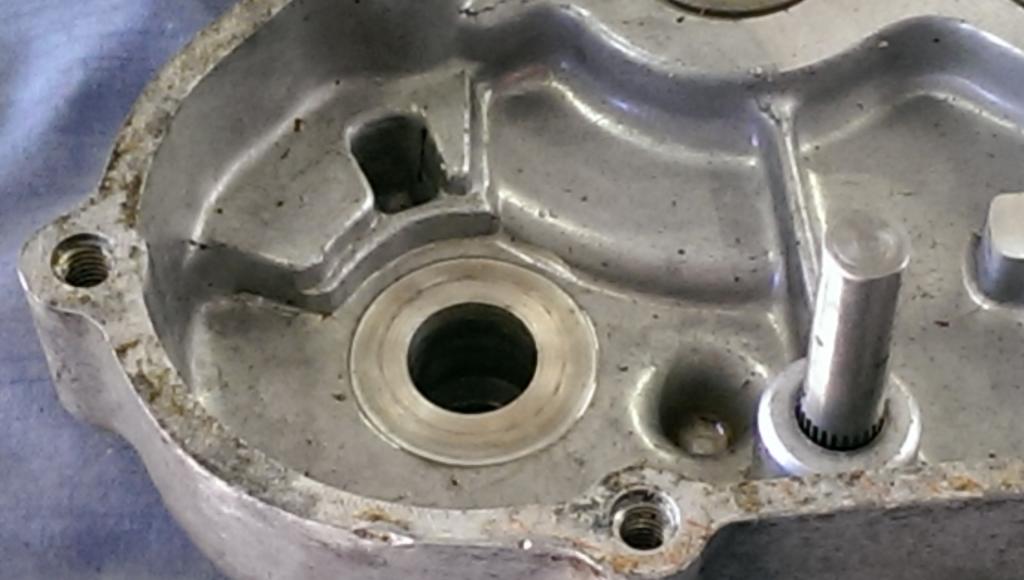

Today I disassembled the kickstarter assembly and carefully checked all of the pieces. It is clean and undamaged. All of the various threads look perfect. I reassembled it into the right side case and tried it again. I got the same results (by the way...why would I expect different results...isn't that a type of insanity???). I removed the side case cover and put everything back where it belonged and then operated the kickstart lever. It became very clear that what was happening was that the stop which is located on the end of the kickstart shaft was slipping up and out of the recess in the side case which was ment to be the kickstarter stop. Below is a picture of the area which clearly shows the grinding or sliding marks left by the stop.

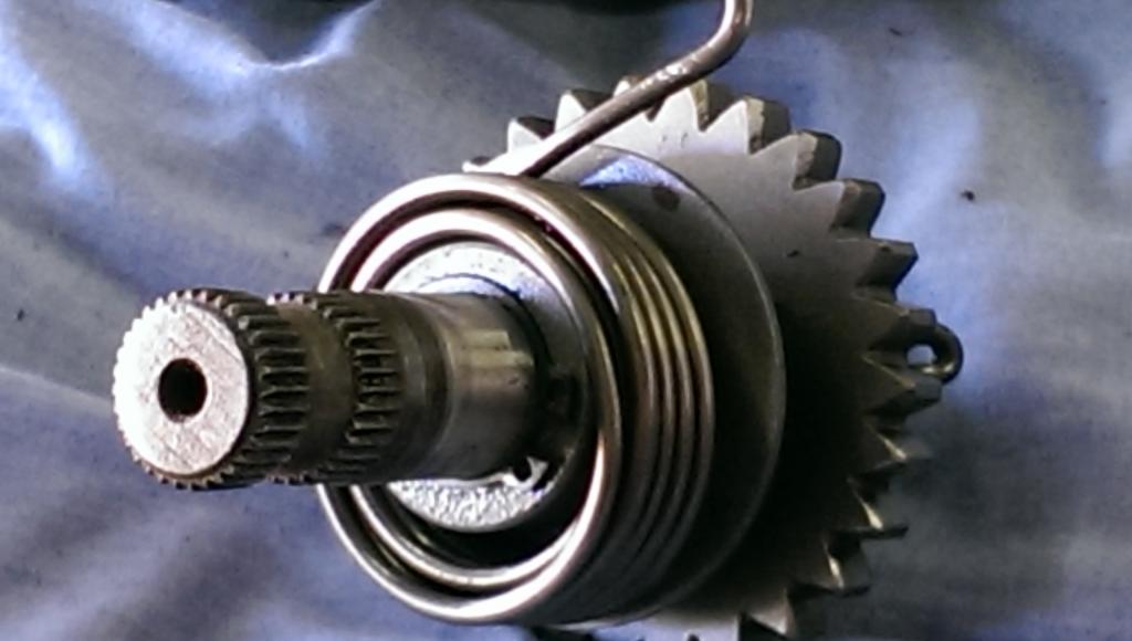

I can see that one solution would be to simply add a couple of shims to the end of the kickstarter shaft (inboard of the side case) which would have the effect of holding the shaft in place. I would rather not do that. Obviously Yamaha designed this mechanism to operate without such shims. I would prefer to reassemble the mechanism with factory correct pieces and have it perform as intended. I am really not looking for a "bodge" solution. There are two other issues with the mechanism that I question. First is the spring guide which appears to be some sort of teflon piece in most of the parts books that I have seen. Below is a picture of mine which is metal and retained by a circlip. Could it simply be too short? It is slightly over 16mm long. Below is a picture. Do any of you have a longer spring guide?

Hi, if a couple of shims will fix it then add a couple. Its only a kick start after all. As my Dad would say...it will probably see me out :)

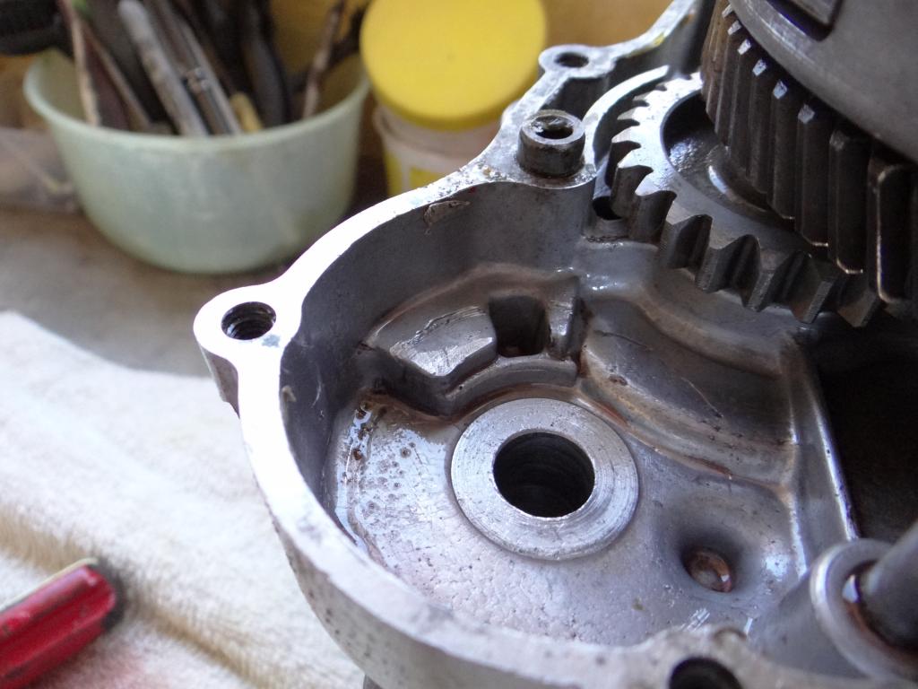

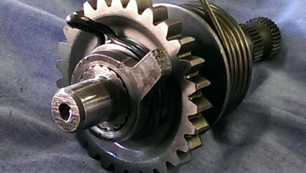

One of the weaknesses of the TY175 kickstart is that the stop is not very well fixed to the shaft. The usual problem this causes is that the kickstart shaft over-rotates when returning, which causes the head of the clamp screw on the kickstart lever spline to punch a hole in the casing.
I've included a photo showing how that stop should look ie square and flush

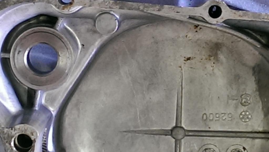

The other thought I had was that you have not shown what your cover looks like - I'm wondering if you are using one of the YZ125C/X covers which might have a different dimension to the inside of the steel bush for the kickstart shaft. The cover I've shown is a TY175 cover
Thanks for the suggestions. I re-examined the kickstart shaft and the stopper on the end is square and well fixed. In fact, after a few kicks the kickstarter does over-rotate and causes the clamp screw to try to punch a hole in the side case cover. This is what happened when I laid the bike up about ten years ago. As a result of that damage I tried to have the side case cover repaired locally by a guy at a VW repair shop who knew something about welding aluminum. He closed up the damage, but the case warped and became worthless. What I am using now for a side case cover is something I got off of ebay. It works fine.

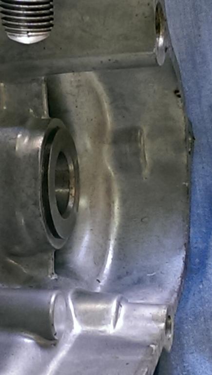

My problem, which shows itself as over-rotation is the fact that the return stop on the end if the kickstart shaft slides up and out of the stop which is moulded into the right center case. I'm approaching this problem from two directions. First, I just ordered a new shaft and sliding gear and spacer and friction clip from TY Trials. I will install these when they work their way to Mexico. Secondly, I've placed a couple of largish washers between the end of the spacer and the inside face of the side case cover. These spacers prevent the kickstart lever from moving out and over the stop which is moulded into the center right crankcase. I just happened to have on hand a box (ten to a box) of 16mm washers. I have no idea why I bought these huge things, but they are perfect for this application.
But I still wonder....why (or how) does the kickstart shaft move laterally out of position allowing the stop on the end of the kickstart shaft to leave its recess in the center case? It just appears to be one of those mysteries...It is not because of the used side case cover that I got off of ebay because this behaviour manifested itself initially when a TY side case cover was in place...
