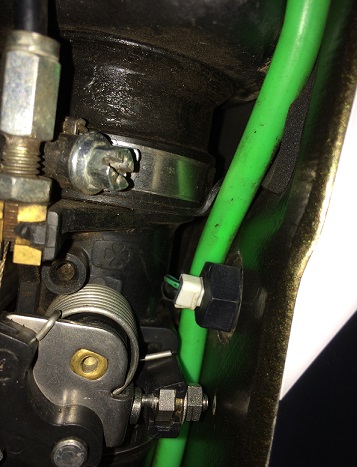

Mine came stock. green and white wires
fuel sender location on mine (2012), wires are green/black and black on sender and green/black and green at headstock connector.
It is an accessory that clips into an existing fitting on the side of the tank with some sort of rudimentary switch inside. It's not very bright and hard to see in direct sunlight. I lost the bulb on mine when it was squeezed out going under a low branch. It lights when you have about a litre left.
The sensor is already inside the tank...
