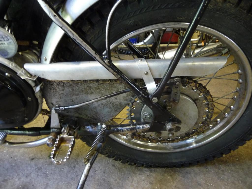

Obviously its harder on a bike with rear suspension as everything moves.But the chainguard on my AJS is the most effective on any bike I've ever had,unless there is really deep,sloppy mud I often don't need to even clean or lube the chain for 2 or 3 trials.
Probably a little more substantial than I was thinking....... but illustrates the point nicely about masking off the tyre
Looks very much like a Bultaco guard
