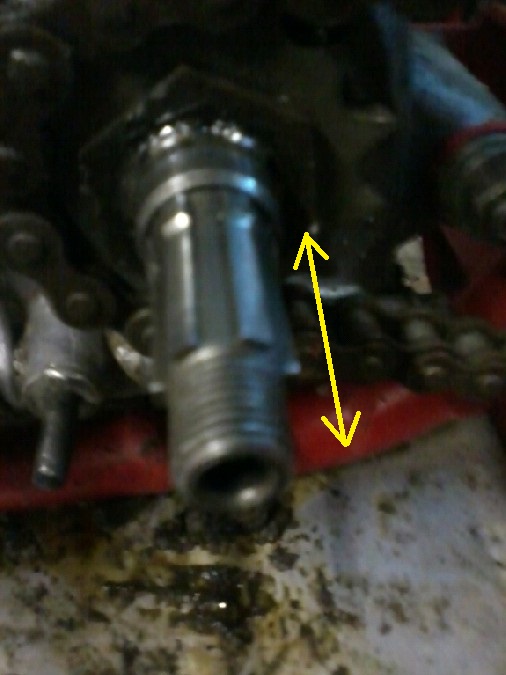

Is the free play on the inner clutch centre or the gearbox main shaft If it is the shaft there may be to much end float in the gearbox Long time since I had an 8e so cannot remember what took up the end float
post-79-0-32135100-1421446266_thumb.jpgThe play is on the inner clutch centre (indicated yellow ) - around 3mm movement

In sure they are
The shaft that the gearbox mounts on is fine, its the inner shaft (that runs through that one) which has the lateral (in-out) movement

Assuming the new clutch plates are slightly thicker than the old, the clutch pack when assembled, would need the clutch push rod to be adjusted longer, this would probably take up the play in the floating shaft, if it doesn't then maybe you've lost a ball bearing in the clutch push rod assembly (therefore not allowing enough adjustment to the clutch push rod). It's 50yrs since I played with 8e's, so please don't take this as gospel, only a suggestion. Probably the gearbox mainshaft has slightly excessive play, but previous post, noted gearbox worked OK, so limiting the end float by clutch push rod adjustment would probably be OK (could even have been part of the original design) and within limits for a 60 year old engine.

Rang villiers services this morning and it appears that it is only the need to adjust the clutch push rod to take up the float (albeit there appears to be a lot of float .... but it is 60 years old...)
Apparently there is an internal adjuster if you take the dust cover off on the kickstart side of the engine.
