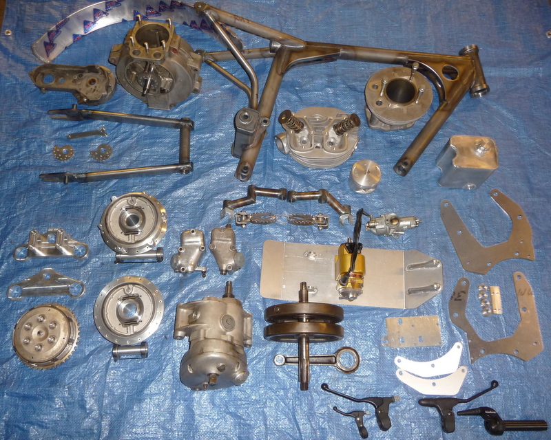

I collected a pile of bits from John Bartram yesterday afternoon for me and a mate,(Well he says he is when he wants a favour...) I now have a new frame and all the other very smart bits that John makes,including the first of the new design of swinging arms we persuaded him to design and make.
This afternoon I laid it and all the other parts I have so far,I thought it would enthuse me to start the dry build... Bit of a shock really,its a realisation of what is ahead. There are some very nicely made bits there,John Bartram,John Budgen,Alan Whitton and Mick Ash are great to deal with,and clearly are able to deliver the goods.I took a picture so I can keep track of what else I need.(To save up for...)
Jon, all looking very nice. Can't see the pile of £50.00 notes to finish it or did they not fit in the photo ;-)
Bezaboy,the pile has shrunk ! Not much left now,but hopefully not that much more to spend...
Deryk, if you look carefully you can see the cable still attached to the mag,its still a standard KNR1... The lever is in the box of assorted bits I didn't lay out on the sheet.Thing is with a nice soft IRC tyre and a well set up engine you don't need to use ignition advance to find grip.I'm experimenting with a modern fully electronic BTH mag on my rigid AJS at the moment,so it has its own advance curve built in.(Even with a well worn tyre it still finds grip like you wouldn't believe)There are a couple of advantages,firstly it cant kick back when starting,(Apparently its their biggest selling point for older riders who struggle to fire up their bikes and cant risk injury) plus the spark is so strong and accurate compared to the messy output from a conventional mag,I think you would struggle to get the engine to run as well at low revs with any points switched mag.
Totalshell, yes there are a few original bits,crankcases,crank,gearbox,(Apart from the Mick Ash gears) mag, (But this may end up being replaced with a new BTH) and some internal engine bits.The rest is brand new,and frankly I wish the whole lot could be new.Couple of reasons for this,firstly the old bits all need work/time - which for me is limited.For instance the cylinder head is a lovely brand new casting,no stripped threads,burnt seats or loose/worn guides.So less time to build before I can ride it.
