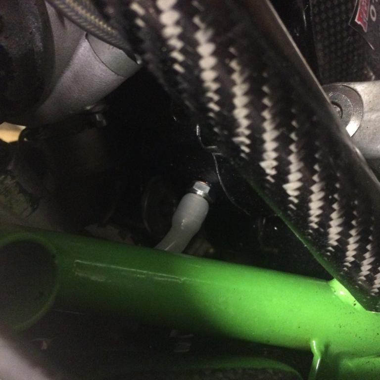

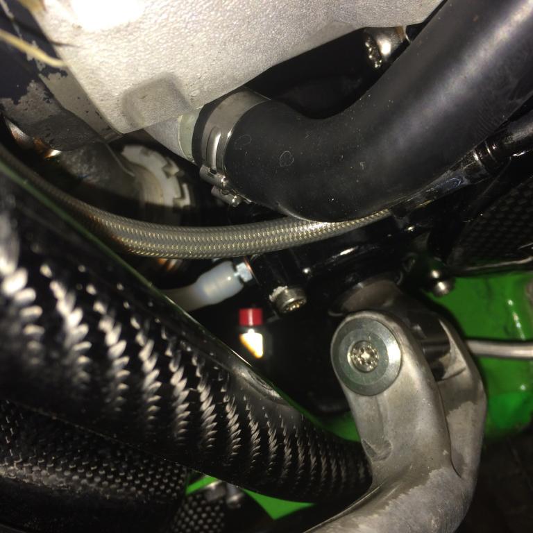

Ossa breather came today and now fitted just
Had to trim the threads a bit
Edited by jsp
Very neat, please report back when you gave given her a good thrashing to see if this cures the issue
Did you just remove the exhaust and go in from the rear (o'er missus......fnaar fnaar) or was it engine out?
yes I just removed the exhaust and went from the rear, take care though I
drilled my hole a bit too close to the frame and struggled to tap it in hind
sight mine should have been 5-10mm futher over to the gear side or I
should have bought a longer tap.
rode for 4 hours on saturday and not a drop of oil came back out !!!!!!!!!
