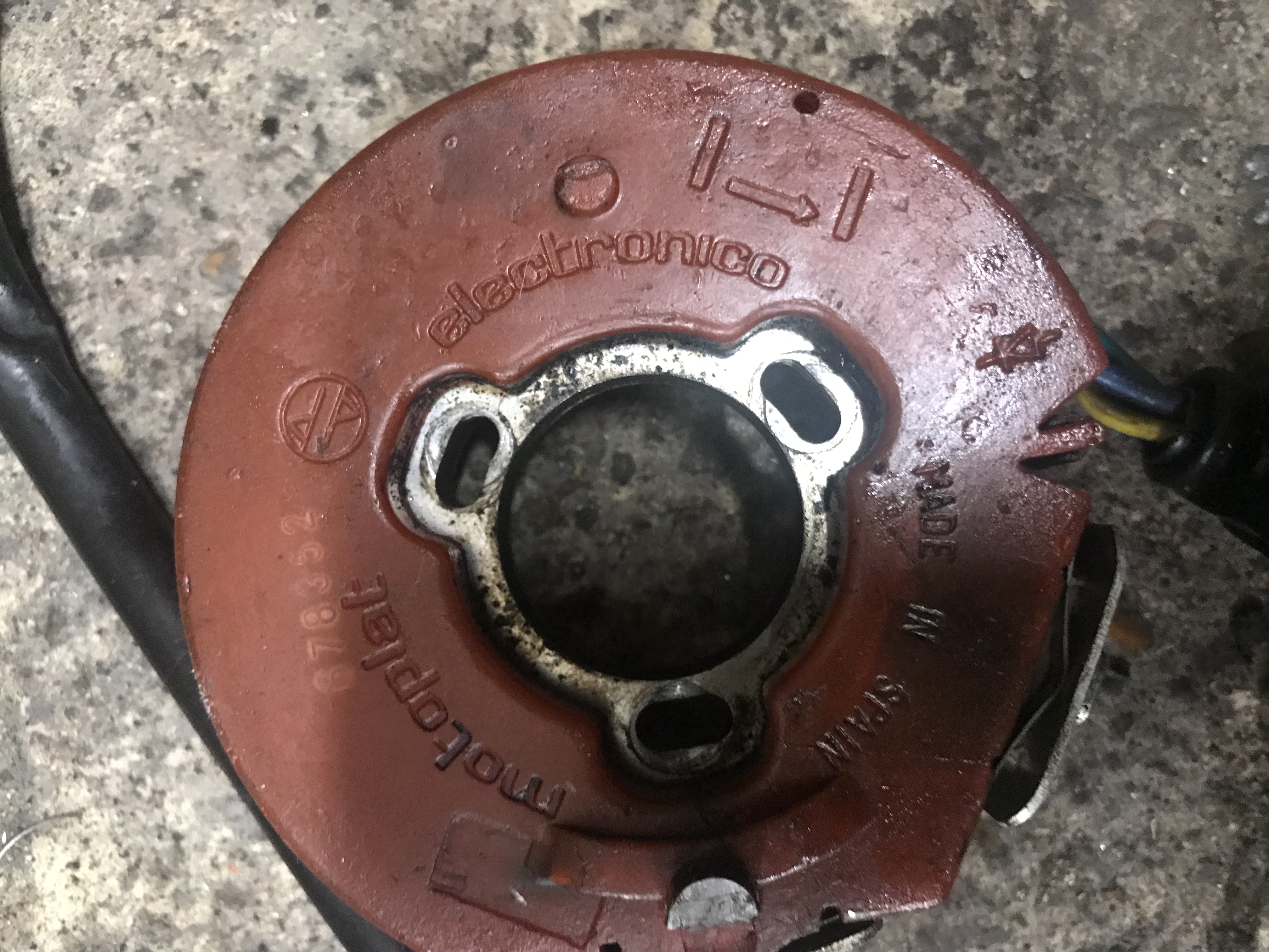

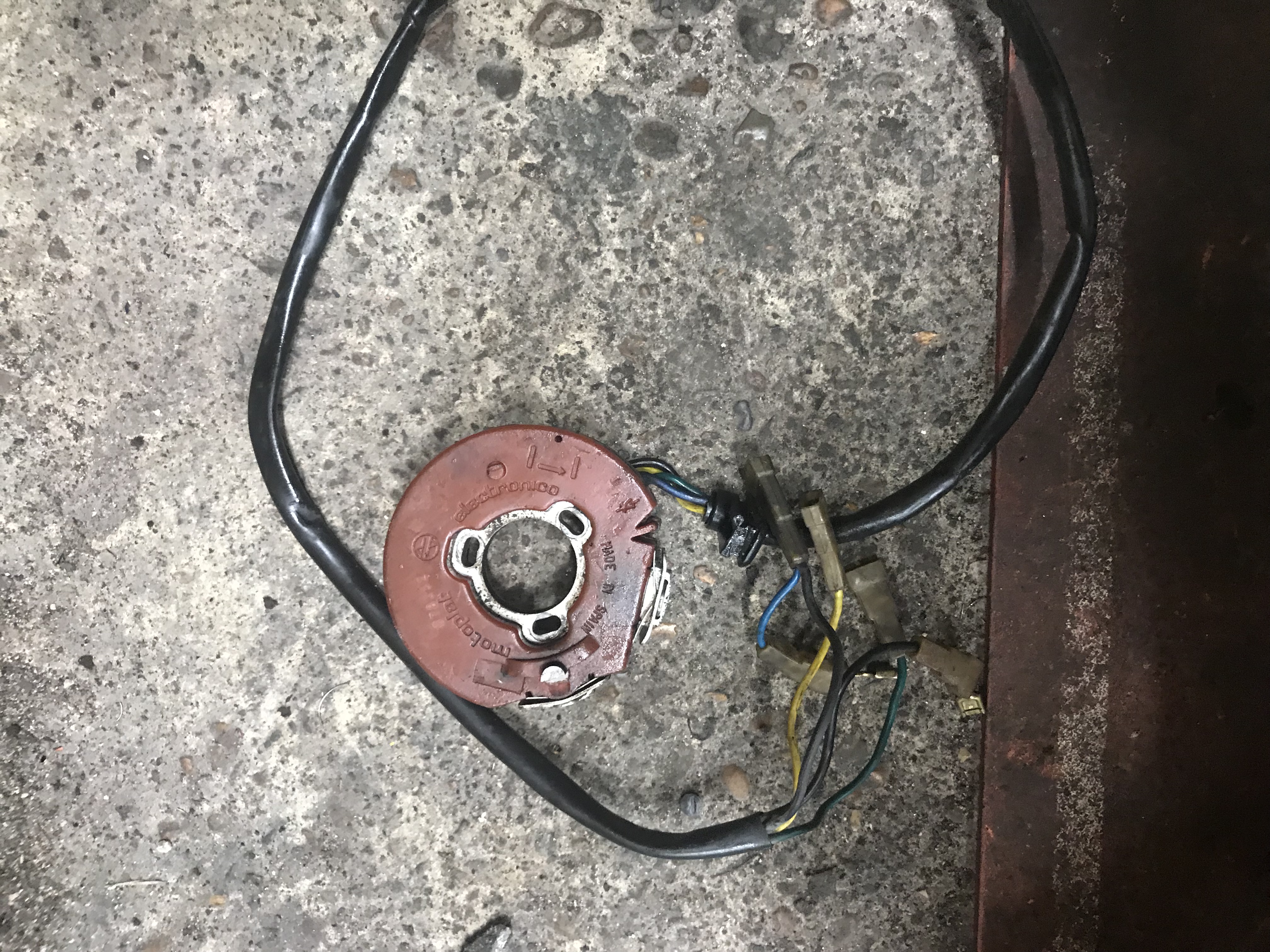

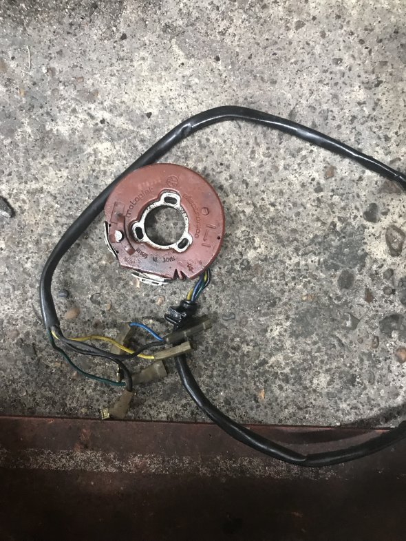

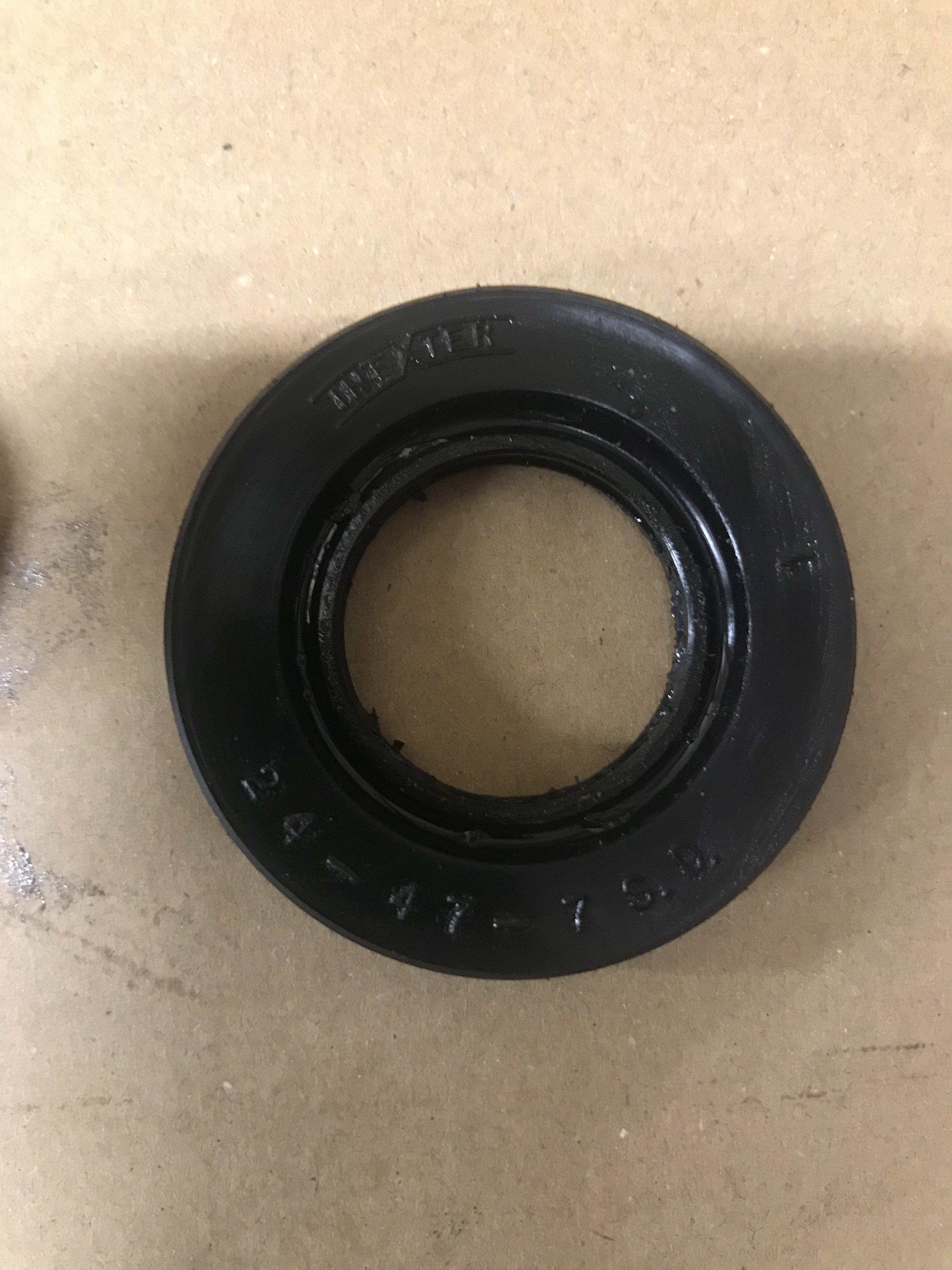

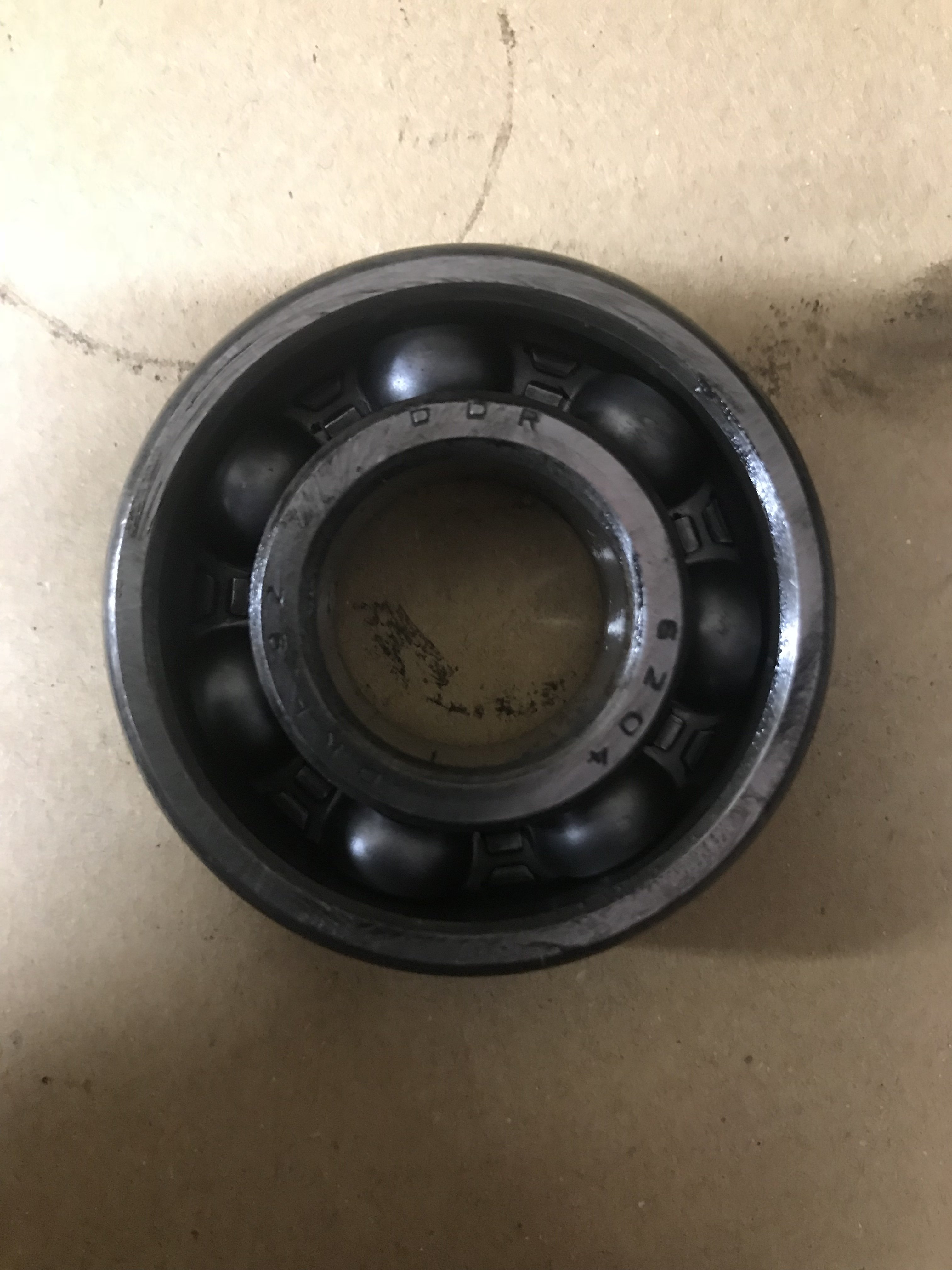

Hi I’m new here and so far really appreciative of the help I’ve had from everyone so big thanks. Quick q? Does anyone have any links to finding the attached. I’m rebuilding a senda 75tt “big bro” of the 50. I’m after the crank bearings and seal kit. The numbers are worn but it looks like 6204 on the bearing. And then the motoplat electronico. I found a CDI unit but this pictured 9809821E-3849-4145-AE99-B8C619F9DFFA.thumb.jpeg.c3017a2de00c6399a5c38a4eaed27254.jpeg59891342-6CCC-4F44-AE64-49528624EB56.thumb.jpeg.5b79050d544ddb814184b21156b19b96.jpegD91AC538-FE6E-41AE-9100-D79E204EB497.thumb.jpeg.b7e413982837287ff78ee8ac6c192a9a.jpeg246F67B2-A3E7-4C52-AE39-83F67294F347.thumb.jpeg.dbe62d4cfb9ea0fca2fc63ae3f6df423.jpegunit is only giving out a tiny spark. Thanks again.  Any leads are massively appreciated.
Bearings & seals are fairly common type, I don't see a C3 on the bearings so any bearing retailer should be able to supply them. Unlike the Japanese manufacturers the European companies used common sized bearings instead of having specials made that were only available through their dealer networks, often 1 dimension would be .5mm larger on the outside in Japanese bikes
Seals should also be available from the same source, ask for 2 lip Viton seals if possible as these cope with modern fuel better the Nitrile seals which are what the originals appear to be
