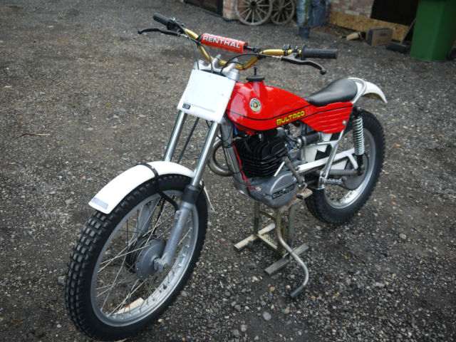

I run a sammy miller framed Bultaco which has a 1975 PM124 engine fitted. it came with a 1971 front wheel and probably the 1971 forks and clamps as well also a Montesa rear.
So, I've managed to grab a barn find: a 1975 PM125 350 and will be using the forks and wheels off this to get the age of it right.
alas the offset is no different between the two bikes and already the front is a nightmare when I trial the bike. the front drives on or tucks under so I reckon I need less offset (and more trail) in the clamps.
yesterday at a Dabbers trial, after much measuring the nearest i can get is a set of SWMs or Honda TLRs. the Honda clamps look as if I'll have far too little offset.
is there anyone who knows what to do here? I believe Sammy is meant to have had the right clamps made at one time? if true I'd like to find a set but if not justy knowing what the flip I need for the right offset would be a huge help!

I don't think there is any difference in offset / rake between any year of Bultaco yokes and if so, changing them won't alter anything with the steering. With your Miller frame, it would be hard to know whether it had '71 parts originally and had a '74 engine fitted or other way around. It could have had anything in reality
I've never heard of Miller doing a yoke set, his frames just used the standard Bultaco parts. He used to do a top yoke to replace the earlier original Bultaco item that was considered weak, but no full set as far as I know
I've never ridden a Miller frame but heard people say they're an acquired taste. I could never understand why, having declared a Bultaco steering to be the optimum for trials, he produced his own frame with a different head angle...
Your front end problem is more likely due to 40 year old springs not being up to the job any more. With correct rate springs and damping working properly, the forks shouldn't dive and cause the problems you're having. If you fit yokes with less offset the chances are the front mudguard will foul the exhaust on compression as they come pretty close as standard.
The other problem with older Betor foks is that the piston on the damper rod is just plain alloy and doesn't have the fibre ring that acts as a seal like later forks do. If the piston wears oil can just bypass it and travel between the piston and inner wall of the stanchion instead of being forced up the damper rod and through the valve. Your M150 forks may have the fibre ring, not sure when it was first fitted. If so you can replace this by cutting new strips from the correct thickness PTFE card available on ebay. This will improve damping effect. You can judge the effectiveness of the piston by placing the damper rod in the top of the stanchion and just letting it go into the tube. If it falls freely to the bottom you can be pretty sure there is room for oil to pass between the bush and the inner wall of the stanchion and that damping effect is being lost. With new seals fitted you have to p[hysically push them down the tube, the difference is marked.
If your pistons don't have the fibre ring you could get new ones machined with a groove in them to take a seal. Easy job for someone with a lathe.

Taffy, it's not entirely clear from your post exactly what the the front end is doing - "driving on" or "tucking under" could be two different things ie have diff causes, or one could be causing the other.
"Driving on" can be caused by wrong weight distribution (eg incorrect footpeg location) or poor front tyre. I've never ridden an SM framed Bul but the early one's were said to have been improved by relocating the footpegs.
"Tucking under" is usually associated with steering geometry, rake & trail etc which you are onto. Most Bultaco pursang/frontera/matador/alpina triples have about 20mm less total offset* than Sherpa T ones since they don't have the angular offset built in. But as Woody says, you'd likely need a new header pipe fabricated to give clearance, & they will also reduce your wheelbase nearly 20mm too. Thats a big difference in both trail & wheelbase.
Sometimes tucking under can be 'cured' or at least reduced by fitting shorter shocks or lowering the ride height at the rear (less preload or softer springs). That's perhaps what I'd be trying first.
Conversely if your bike has been fitted with longer shocks that often worsens tucking under. Or if your front end is sagging that can worsen it too.
* Edit: total offset is offset at the axle, taking into account the extra angle built into the Sherpa T triples/yokes
Edited by jc2
well oddly enough the rear shocks are shot and I can't speak lowly enough about the present forks. there's no oil in the rear and not only that but someone welded eyelets above the top of the std fitment thus jacking the rear.
fact is, if the headstock has been sharppened 4d then the offset MUST be reduced accordingly. it's about 2mm to each degree and so I need to lose 8mm and I figure the offset right now is 36.5mm give or take with the 1971 set. '71s don't have a top pinch bolt and have a taper to the top of the legs.
the 1975 set that I'm preparing to fit seem to have an offset of 30mm. this 30mm therefore needs to become 22mm give or take.
it should explain that I'm getting the double whammy of a jacked rear end AND on a bike that needed 8mm less offset before that happened!
I'd have liked to try a set of SWMs if I could get them measured more accurately than running around the paddock poking a vernier where it doesn't want to fit!
as for space to the zorst well I check that everytime I pull the front end down on the trailer and at full travel there's 10mm still so I fear nothing there.
thanks for the advice on the internals, i'll have a look at that? being 15 stone do I want to lose 25% travel stood or 33% on the forks?
new rear shocks coming up.... but I daren't buy them till the offset and feel at the front is partially sorted.
I've got re chromed legs, steel sleeved brake hubs, new spokes, new wheel bearings and seals and I'm going to try SKF seals as I sell them and they are sooo fab on everything else! the quality is tops..... new IRC tyres and shocks will finish the job nicely.
it looked so pretty on ebay................
regards
Taffy
Edited by taffmeister
