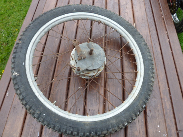

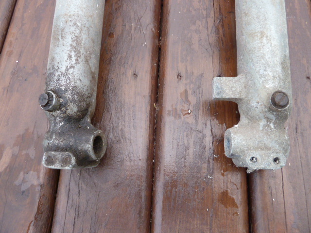

Can you please identify these Forks/Wheel, seems to be from Bultaco or Montesa ???
Are they usable together  ??

looks like a ty wheel forks not Bultaco
Forks are Ossa, wheel looks Montesa 247/348
You can use anything together if you can make them fit

Montesa has a bracket for the brake so it aint that i think. Ossa MAR could be!
Looks bit like bultaco, but those have the lower parts of the forks bent forward, this one looks in line with the forks.
Edited by crazybond700
I put Montesa by mistake (writing on another forum at the same time) and didn't finish editing it  -  its a Yam TY wheel, Yam torque arm lug and speedo drive  in brake plate
Forks are Ossa

If i want to use this fork/wheel together . i need to use torque arm correct . there is no mounting hole in this fork ,  or i can hook it with mudguard mounting holes ?

If you are going to use the Ossa forks, you will need to make a brake torque arm for the TY Yamaha front wheel.
I would mount a triangle bracket onto the mudguard fixing holes, and the a straight two holed  torque arm to connect with this and the hub back plate,
Take a look on the "Otter" site to see  how they should look.
You will need to find yourself a 18" rear wheel,probably Cub or Bantam is best? you can't get a tyre for the 17" wheel.
Yes you could use Japanese forks and wheel, but why not use what you have got.
A new wheel spindle will have to be made, but this is a simple job for someone with a lathe.

I will use Ossa forks/TY wheel as suggested.
