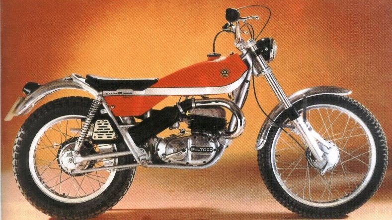

 I want to fit my front mudguard to a model 80 sherpa using the original shaped stays. I don't have any of these but I reckon I could make them easily enough with a little help.
If anyone has a bike with these on it (twinshock maybe) could you do me a favour. Could someone screw them off and try to make a drawing or template with a few dimensions on it. It would give me a better idea than just working from a photo.

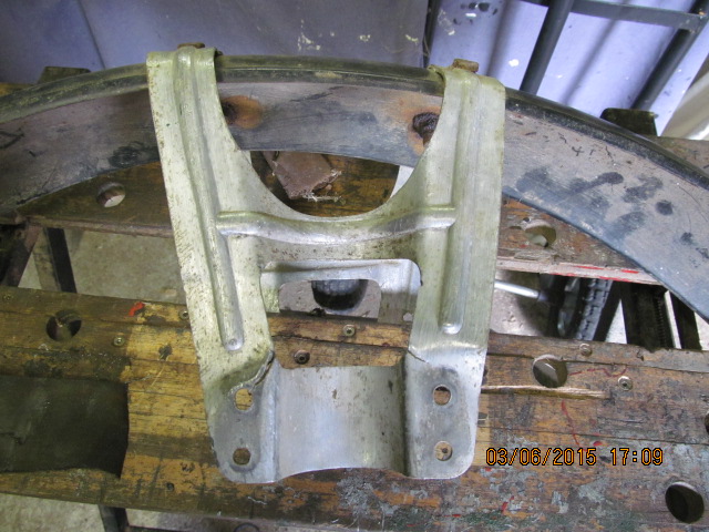

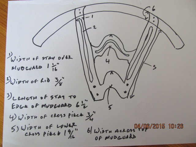

The stay on my Sherpa is kinda similar but I found they break easily. Anyway I'll post a pic and a ( poor) drawing with measurements if it's any good.
Larry 2.
Larry that's a great bit of work and easy enough to understand, appreciate it. I've never seen a bracket like that one before.
If I'm honest I'd still like to make ones similar to the top picture.
What thickness is the aluminium in your bracket, I was thinking 2 mm would be ok.

Trailie, yep, its 2mm alright. I agree the stays in the pic look better.
