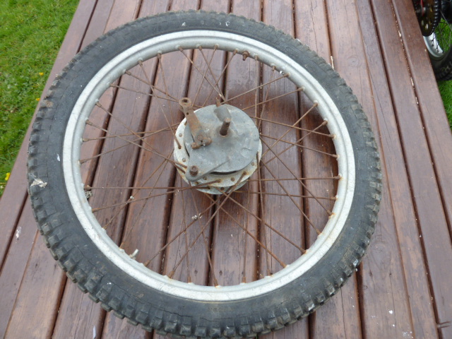

Yamaha Ty Brake Shoe Size ?
Hi Guys
What is brake shoe size of Yamaha TY front wheel as shown below & where i can buy bearing & brake shoes for best prices ?
I think the wheel is Yamaha TY 175 or something not sure ..please advise.

pull shoes out and measure drum diameter, recon that will be 110mm. Just got some from ebc website get grooved sintered ones for best braking.

 Look try trialsbits.co.uk
The number shoes you want is Y504G, these are the ones with the grooves for water.
Regards Charlie. PS bearings for steering head ,try simply bearings.
