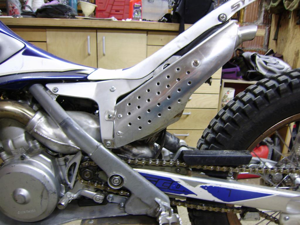

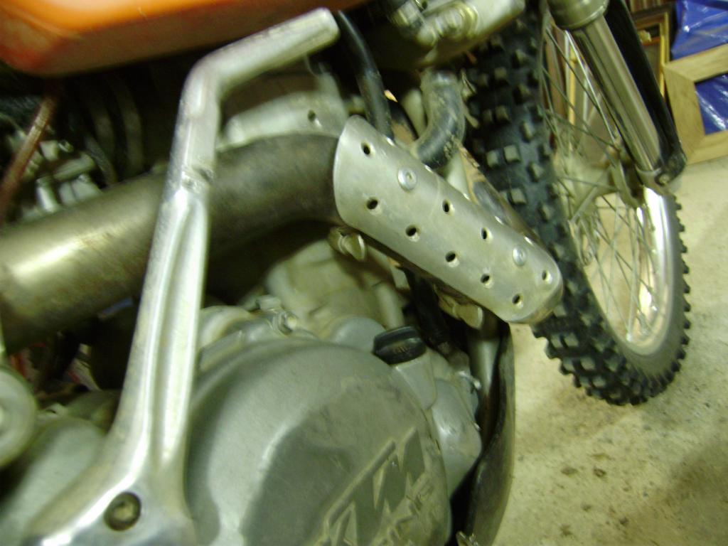

Mine is 06 and grab uphill well, could be carb issue. I am just careful not to touch the headpipe, but I have installed some kind of aluminum screen over the silencer, to protect my left leg.  I made a screen on my KTM headpipe, it could be idea for you (fixed with two hose clamps, easy to move or remove). Hope the pictures shows what say.
Exman that's exactly what I need to do!! Cheers :-) found a carbon header guard but was unsure how it fits.
