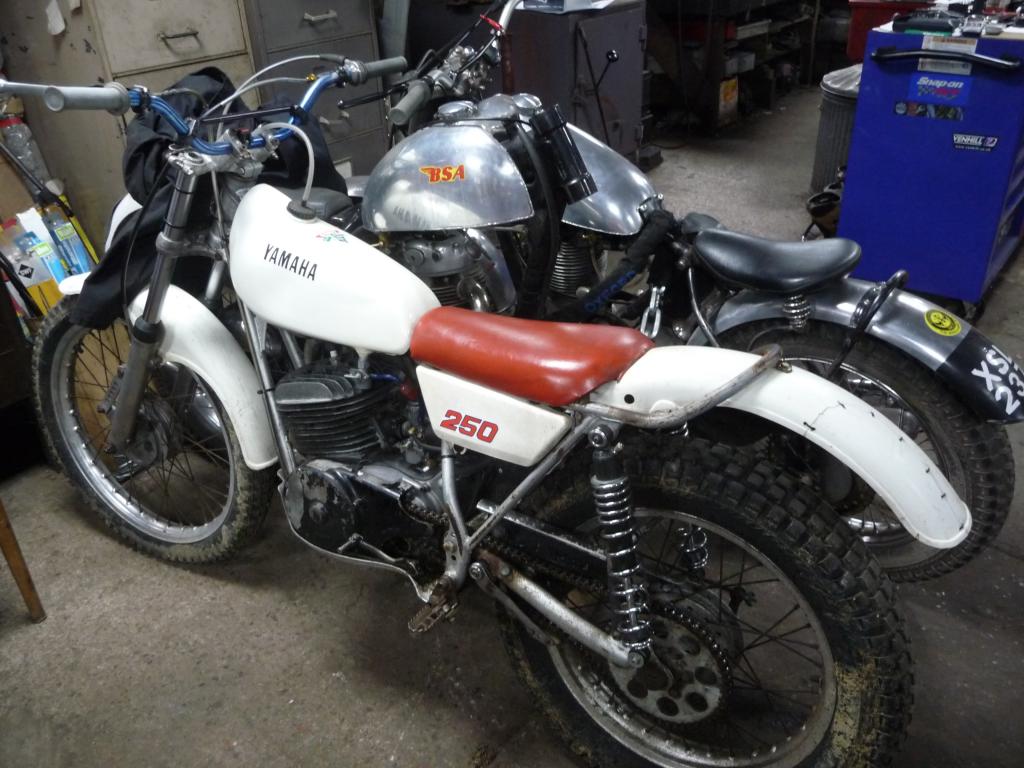

Just a thought.... Back in about 2007 I bought a TY250 twinshock as a non runner / spares bike. It has sat at the back of the pile of bikes since then totally untouched, a couple of weeks ago I spent a day digging it out and making it into a trial ready ratty hack... I rode the first Golden Valley evening trial on it and it went well.This afternoon I took it up in the woods for a play practice with a mate and had trouble shifting down through the gears - from any gear shifting to a lower one.I got around it by lifting the lever slightly before pushing down.Feels like a weak detent spring or similar to me,it doesn't jump out of any gears once selected. I'm using Land Rover MTF94 oil in the box,which I used without problems in one of my other TY250's for the last 9 years, and the clutch is in good shape, freeing cleanly and taking up drive very smoothly.
I've never had a TY250 clutch/gearbox problem before so have no previous memories of them,just a reliable / abusable bike...
