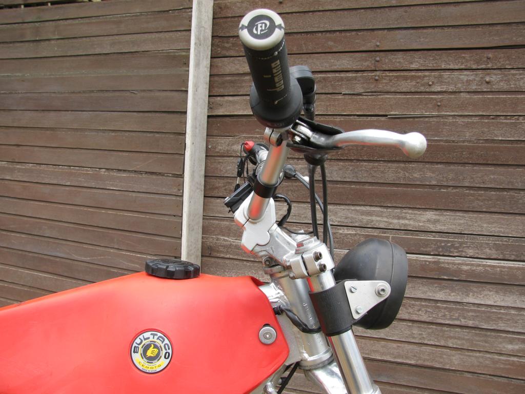

Hi all,
Has anyone any experience with the Jitsie handlebar risers?
Front end feels way too low on my RTL and don't want to alter the frame to move foot pegs.
Thanks!
Mark G
No Mark, but I would imagine that using them will bring the bars closer and increase the tiller-effect because the clamps aren't parallel to the yoke.
I fitted Fat bar conversion clamps which also act as risers to a Tlr.
The set up is similar to the Rtl and it worked very well.
