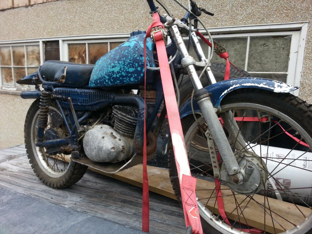

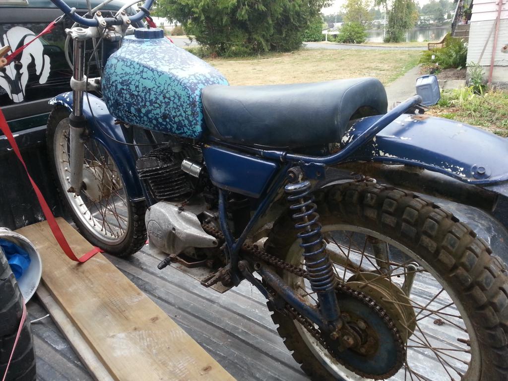

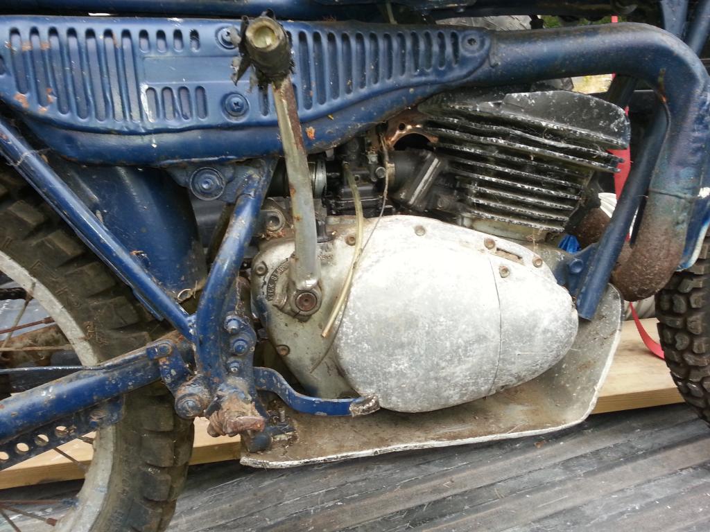

just took a gamble on this bike for $50 cdn. breaks are siezed engine is not. tank and seat appear to be honda xl? lower frame section was replaced with some checker plate aluminumm
some digging on the net leads me to believe its a ty250
any ways just posting here as this seems like a good place for reasearch and advice. while i figure out what to do with it. if its even worth fixing,parting out or just scrap metal.
please feel free to post sujestions.

Its a TY250 A and the forks are back to front as is the front wheel. Probably cost more than it would ever be worth to restore better to break it and sell of as spares. That way you should make a profit.
See if you can get it running, Turn the forks round then have a go on it. It doesn't look too bad to me from the pics. The forks will need a re chrome, that's expensive.

Fuel tank is IT Yamaha 1977/78
It's a TY250 frame and they never had tubes under the engine and the original A model bashplate was rubbish
It looks complete enough to me to be resurrected for trials use here in Australia

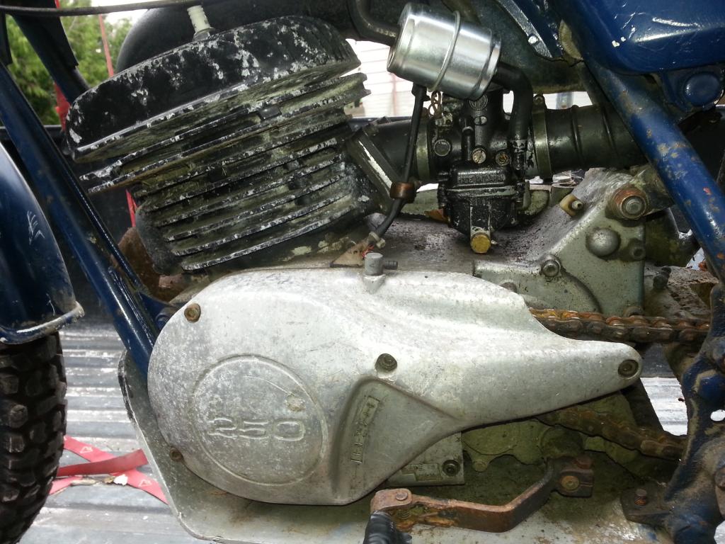

It has a TY250 B model carby
The motor and frame look like A model
A model frame and motor should have numbers that start with 434
I'm intrigued with the extra bolts through the frame plate where the swingarm pivot attaches on the RH side of the bike

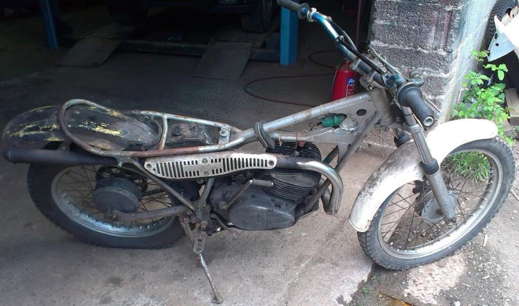

                                                                                                                                                                                                                                                                                                                                                                                               post-3125-0-54436500-1439629897_thumb.jpgI'd have a go at getting it to run, a couple of months ago I was in the same situation with a 1978 TY250 that I had bought several years ago as a breaker. It has cost me about £150 in parts to get it to a state where I was happy to enter a trial on it. It looks like an absolute dog,but goes and rides very well. I've done a couple of local trials on it and had a great time on it.
