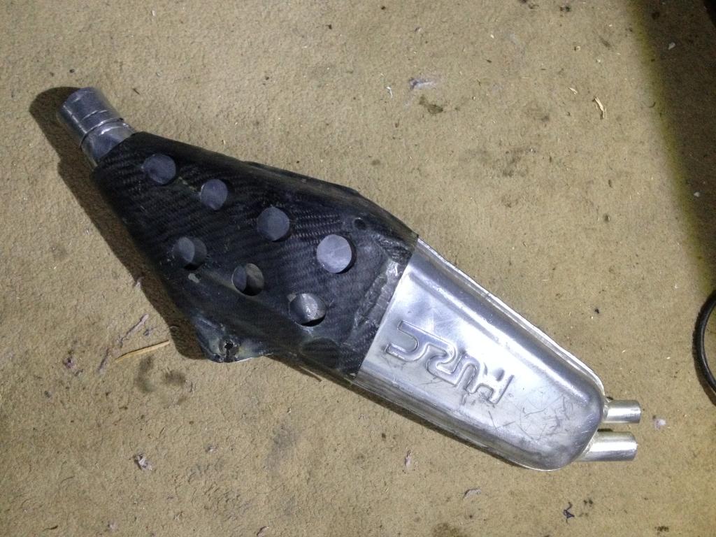

I made one from fibre glass.
Bought the bits off the internet and followed instructions how to make "glass reinforced fibre parts" on You Tube. I used the exhaust as the mould so the part was a bit tight. If I was going to do it again I'd want to make it a few mm larger than the exhaust so I could have room for heat insulation or air between the heat shield and the exhaust.

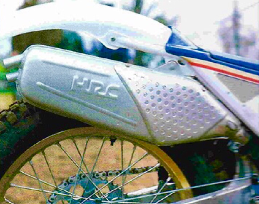

This the factory one, obviously it's a larger silencer, something just like this, but for the standard silencer would be great.
I prefer the one in jj65's picture, screwed on, so it can be removed for cleaning.
Yep, jj65's picture shows what I would like if anyone knows anyone........
It looks like its riveted on or something similar. The only way I can see to make one is to attach it to the exhaust bracket at the top and the clamp at the bottom. Looking into it though as its something I've wanted for awhile.

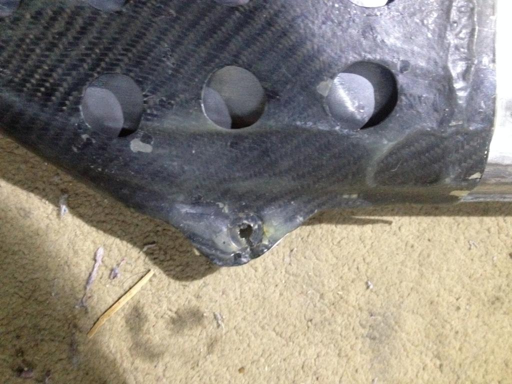

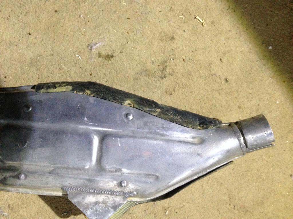

I took the opportunity to take a photo of the heat shield I made by making a mould from the exhaust. There are videos of how to make carbon fibre or fibreglass parts on YouTube. It uses the bolt hole on the frame for the top and folds under the bottom of the silencer this way it just clips off after a muddy trial.
