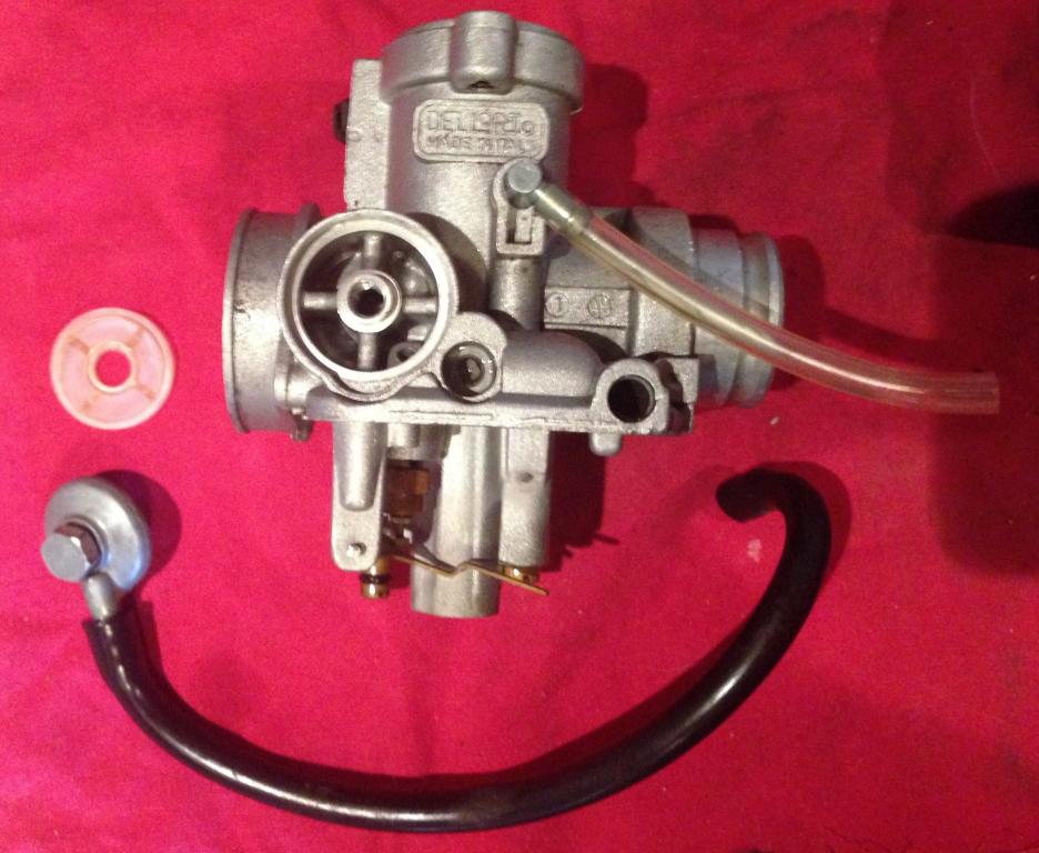

sstout Posted February 22, 2016 Share Posted February 22, 2016 Clean out the internal filter on the carb to, it's behind the inlet from the fuel tank, a 10mm spanner opens it up and its an easy check... new one is a couple of quid from Splatt Shop if it is damaged. see attached pic Quote Link to comment Share on other sites More sharing options...
strugglinon Posted February 25, 2016 Author Share Posted February 25, 2016 So it turns out that the carb doesn't have a link pipe. It's been removed. The filter was a bit dirty and a little crap in the bowl. Air box was drenched, cleaned dried and filter oiled. Refitted and sealed up the gap between airbox and the fender bracket. Also it had the wrong plug in. Started after a while and ran noticeably crisper. Need to do a long run on it to be sure, but it seems to be a lot better....... 1 Quote Link to comment Share on other sites More sharing options...
