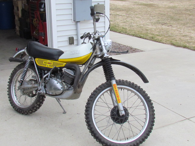

Twinshock dude-
  I like that response.  Kind of generic info on the fork oil quantity.  My forks are "generic" and I don;t know their source or history, but they do the job.  34 MM and the front hub and wheel are off of something else, but it all works fine.  I just wish I knew what it was from.
