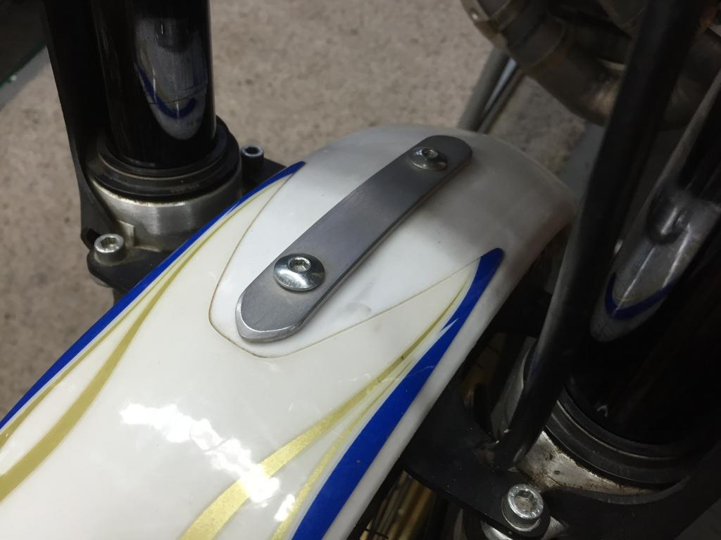

beta_blocker Posted August 12, 2016 Share Posted August 12, 2016 A small piece of aluminum strap (curved to match the fender) with a couple of longer screws helps spread the fender and helps the two mounting points from cracking in a crash (which they do easily). 1 Quote Link to comment Share on other sites More sharing options...
jasonquinn Posted August 12, 2016 Author Share Posted August 12, 2016 A small piece of aluminum strap (curved to match the fender) with a couple of longer screws helps spread the fender and helps the two mounting points from cracking in a crash (which they do easily). That looks great! Thank you for the help and idea. Quote Link to comment Share on other sites More sharing options...
