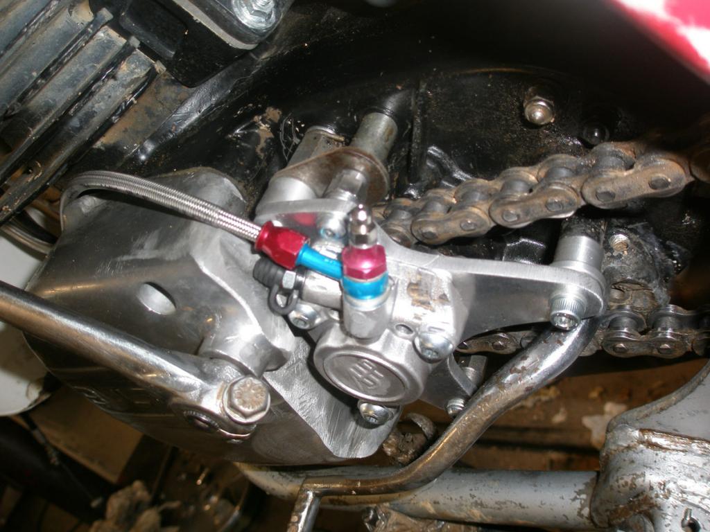

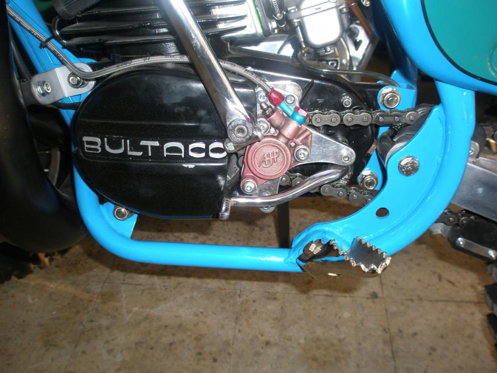

I have often wondered what the hydraulic clutch converstion offered by Romero Motos are like.
Edited by model80
That looks like half a 2 pot caliper used as the slave cylinder rather than the dedicated slave cylinders that modern bikes use
May ne a very early modification?
