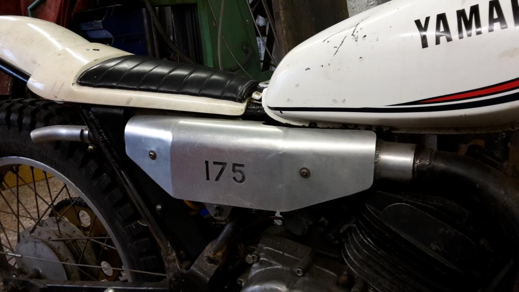

My dad is sorting out his TY175 and we're looking at exhaust options. He has the original system and what we think is a WES system. This comprises a front section which fits to an alloy mid box without the extra end can. It looks similar to the system on the Sammy Miller site but the front section is not stainless. Does anyone know if these used to be made with a plain steel front section?

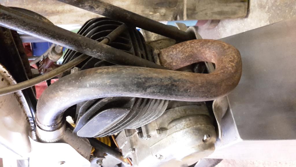

Best pictures I can get.post-16373-0-15681500-1472993807_thumb.jpgpost-16373-0-62496600-1472993889_thumb.jpg
The header section could be what Sammy Miller products sold many years ago, or it might be home-made. The SM products item was made from pre-formed bends like yours is and like many home-made headers were/are. I would tend to think it might be home-made because from what is visible in the photos, the radius of the bend that goes over the head is too big to be the old SM Products item.
Yes the main section is a WES with a home-made heat shield. Can't tell from your photos if it is the one-piece WES or the front part of the two-piece WES
Looks like a fairly non-standard frame. Any chance of photos taken side-on, showing the whole bike? That will also show the shape of the exhaust header better

The pipe was definitely brought but we can't remember from where. The heat shield was made in house.

It's a one piece unit on there at present.
