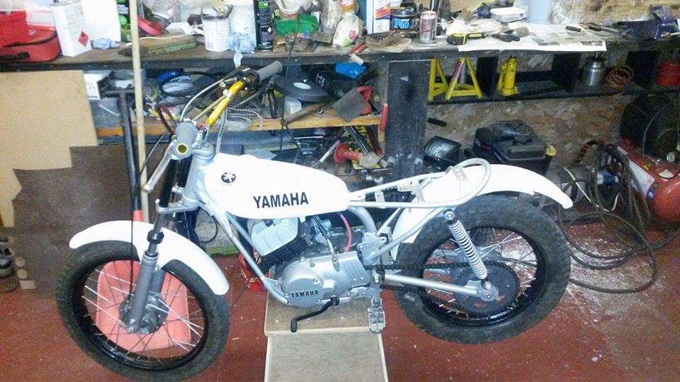

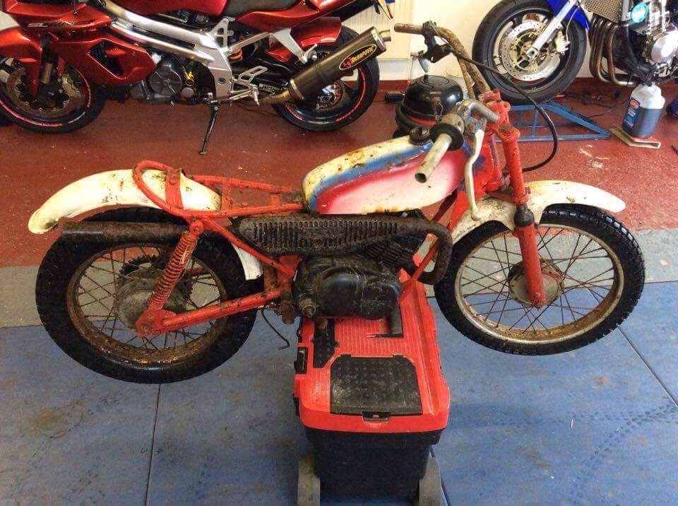

December 17, 20169 yr Author Hi, I'll try a small update of progress with the TY, she's not going to be original especially with the tank. The tank was a mess, full of holes and filler! After silver soldering up the pin holes, resin lining the inside and for belts and braces a full coat of fibreglass all over the outside, it is now bullet proof. I wanted to do something a little different from the standard graphics. this is how she is ATM, still in the progress of making a seat unit, then airbox. This is how she was when I got her! She was apparently destined for the skip before the fellow before me salvaged her. I have various pictures of her as I went along. She was never going to be showroom or 100% original but atleast she'll perhaps live on a little longer.
December 17, 20169 yr Author There was plenty of parts missing and other bits rotten with rust, I think what saved the frame was over her lifetime she has had multiple colour changes and has held the rust at bay from the frame and swingarm. Unfortunately the rims and spokes were bad, I managed to salvage the rims but had to replace both front and back spokes. The front forks were pitted beyond repair so I managed to source a second hand pair that were fairly corrosion free on the stanchions, so stripped and rebuilt with new seals etc and repainted. Exhaust was pretty ropey too but I've welded it up best I can with what metal was left to weld to, it will have to hold until perhaps next year I'll build a complete new system basically copying the original. Anyway I'll not waffle on about what's been rebuilt, replaced etc but I will say, what a fantastic starting little machine, way better than my gas gas. Only snag ATM is the rear shock seems to close to the chain? But all spacers etc are in place. The split link actually touches the spring as it goes past? Any ideas as to why that may be? Unless something is twisted around the frame/swingarm
December 17, 20169 yr it's looking good The only thing I would add is a rear sprocket guard (I saw someone lose some fingers when I was in the schoolboys!)
December 17, 20169 yr Author Thanks ? Yes a chain guard will be on the to do list, I'll look into that. I'm wondering if I can get something that will cover the chain and also wrap further around the sprocket. I may need to fabricate something, the original chain guards look quite minimal for protection. Don't think the wife will be to happy if I come home with 99% of the boy lol
